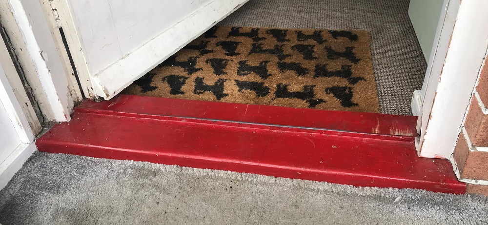

I'm looking to replace an existing wooden front door and frame with a new composite door set.
The question I have is the existing door has a concrete sill with a metal strip inset as per the attached picture. I suspect it's going to be hard work to remove it so I'm looking for opinions on my options, which I see as:-
1. Leave the existing sill in place, angle grind the metal strip down to the level of the concrete and then fit a composite door set with a shallow threshold on top of the existing sill.
or
2. Removed the existing sill and replace with a sill supplied with the door set.
Any advice or previous experiences welcome as I'm struggling to decide which is the best option at the moment.

by stoneyboy » Wed Apr 08, 2020 9:56 pm
Hi DIY-genie,
Much better to remove the old cill - borrow/hire a small breaker.
Regards S..
