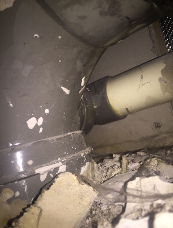

I want to replace a bathtub with a shower tray, and want to put it at the lowest level as possible.
The current 40mm waste pipe of the bathtub is connected to the vertical 110mm pipe 5cm above the floor level (see picture).
I would like to connect a new pipe touching the floor slab, so I can put the shower tray 5cm lower (The floor slab is concrete, then I cannot break it).
The problem is that at floor level there is another connection and therefore they cannot be connected nicely with something like in the second picture.
I was thinking drilling in the 110 pipe and connecting the other one with some kind of epoxy resin? Would that be durable? Any other ideas?

It is hard to see what is going on there in your picture is that 40mm pipe going into the side of an 4 inch elbow?
not sure but would you be able to put this in
http://www.toolstation.com/shop/Roofing ... 0mm/p24326
with 40mm solvent weld boss adapter
lets have a look
