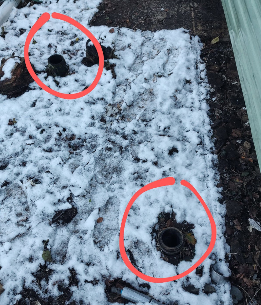

Here's a (slightly) better photo of the two pipes near our caravan.
Are they both inlets? Or is one a valve? Or neither?
If they're both 'In' pipes, how do I know which to connect the waste pipe to? And what happens if I get the wrong one?
Thanks everyone.

You don't want to connect to the wrong pipe, call a specialist septic tank pumping company and ask them to come and look. (Septic tanks must be pumped out every few years.)
