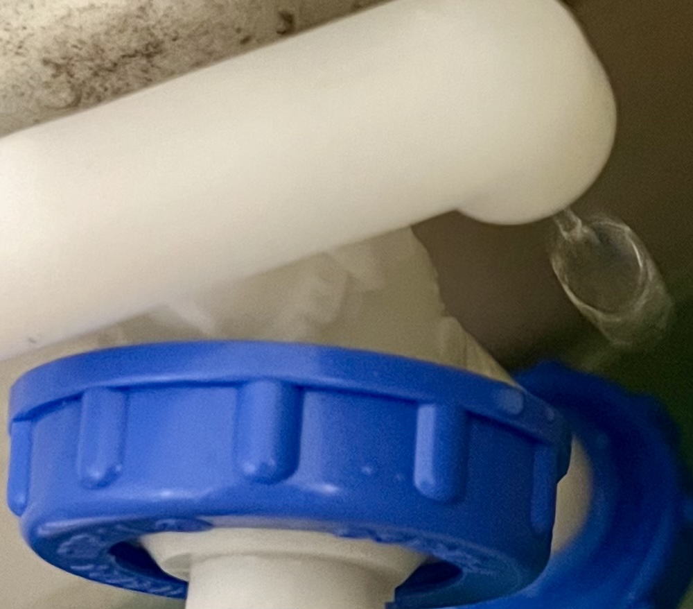

This little pipe is constantly dripping. I’ve tried tightening up various bits but it won’t stop. Any suggestions?

Hi jholden40,
Most likely - the washer in the valve needs replacing.
Less likely - the water level is too high and water is flowing out of the overflow or into the pan.
Possible - if you have a plunger type flush unit the washer on the bottom of it has perished.
