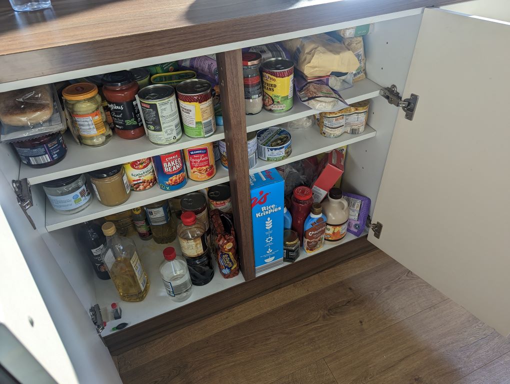

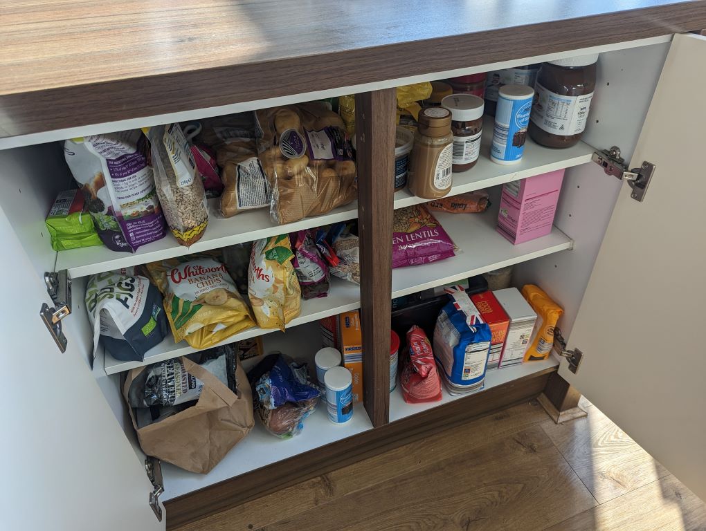

Hi All,
This is my island pantry. It's shelves, disorganised and very hard to reach anything in the back without pulling almost everything out.
I want to convert it to pull out drawers instead.

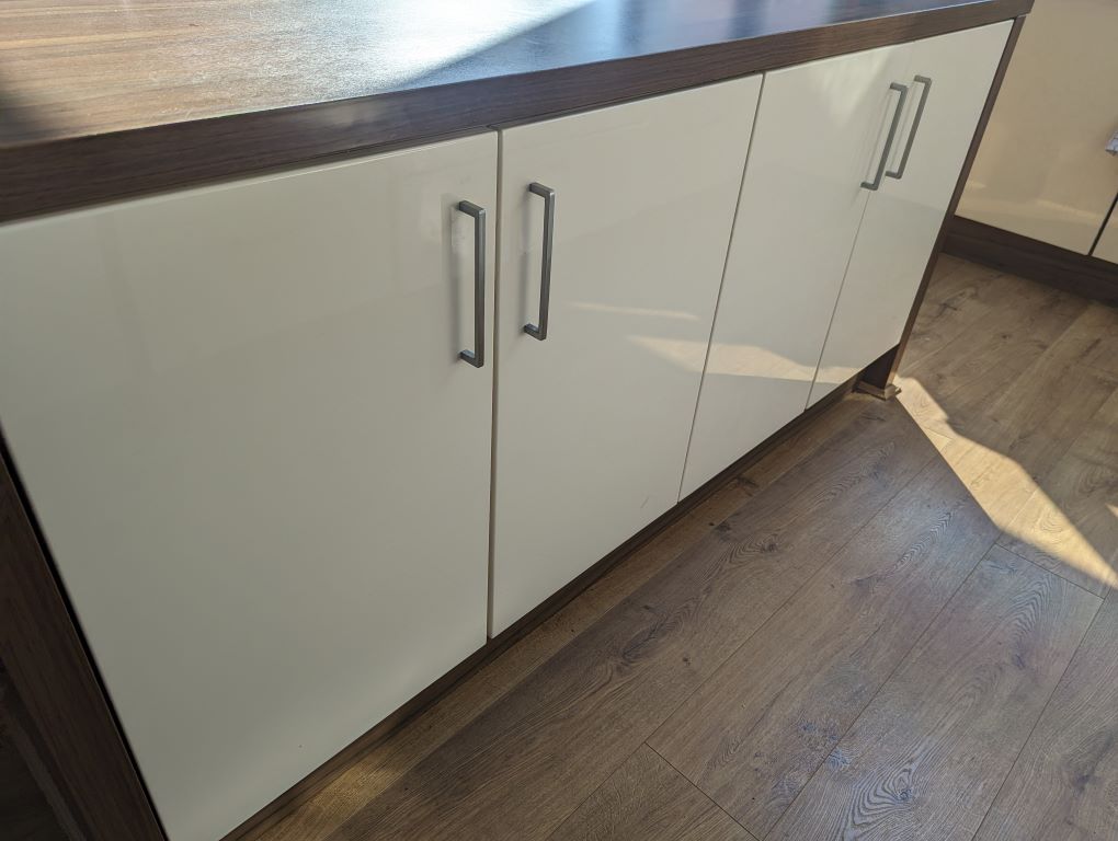

I can't change the cupboard faces as it currently matches the whole kitchen, and as much as I'd love to redo the whole kitchen, I can't afford it.
So I'm looking for some simple internal solutions.
The centre of each cupboard has a supporting pillar in the front. It doesn't go all the way in the middle, so at the moment there would be no way to attach a drawer slider on each section.
Does anyone have any ideas?

by stoneyboy » Mon Jun 19, 2023 10:21 pm
Hi magsme,
You will have to fit a central divider and then you will be able to instal wire pullout trays - have a look at Hafeli to pick something of around the right size.
