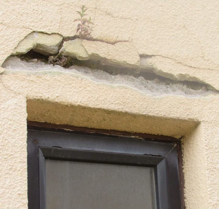

When I moved into my house in 2009 there were no problems internally but the external wall had a few cracks in it. Over time these cracks became what you see in the photographs below..
Around 2013.. Mold and damp began forming on the internal wall and no matter how many times I would clean it - it would return. Anyway long story short, after finally getting a massive overhaul to the outside and inside of the house at the end of 2018 - all the damp and mold had been sorted and gone.

The damage on the External Wall... (The mold and Damp are on the Internal Side of this Wall

Water will get into your house structure through any cracks in the rendering or painted brick wall. If you have solid walls (rather than cavity walls) this will cause you problem with damp and mould on internal walls.
Get the outside made good and see if this cures the problem but it may take many months to have an effect.
