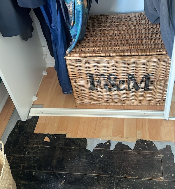

I need to cut laminate flooring that is already laid over floorboards (A wardrobe has been built over it from ceiling to floor and I don't want to remove the wardrobe.
Do I need a circular saw or is there an easier way? Don't want to cut through the floorboards. Thank you

Best to use a mini circular saw but you will still have to remove the door floor track to give you access. If you are ok cutting along beside the floor track you could use a floorboard saw - these have curved blades.
