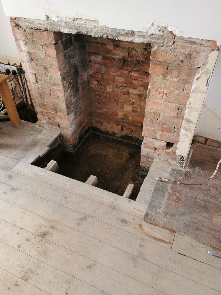

Since moving in, I have cleaned the cavity walls out to around 150mm below the internal cavity leaf DPC (one brick lower than the external skin)
I have also removed everything from underneath the hearths in the dining room and living room, with a plan to replace the hearth in the living room with suspended concrete.
Living room hearth before removal
Living room hearth after removal below DPC
Dining room hearth before removal. Now removed all the way down to oversite.

My question however, is now that we have just about removed all the bridging. How do I make good the actual walls?
We have been told that we need to protect against next door neighbour. As its more than likely their chimneys are also backfilled with rubbish and making the party wall at those locations wet. And it has been suggested to install a meshed membrane to the chimneys and walls for this, with plasterboard dot and dabbed on top.

Chemical DPCs are not a failsafe system and are generally only guaranteed to prevent damp rising up the walls when used with proprietary cementitious plasters up to at least 1 to 1.5m because it's impossible to know that the chemicals have penetrated the mortar bed completely. If I wanted to be safe I would want to check that the existing DPC is still in-tact and functioning and if in most places it appears to be broken then I would want to install a new physical DPC in the course above the existing, or perform a patch repair to the existing if it's mostly in-tact. Plasterboard is appropriate because it avoids the issue of water-borne hygroscopic salts coming through from the damp brickwork, though they can migrate through dot and dab so battens are preferable. Consider also other sources of damp beyond the bridged DPC like a leaking subfloor pipe, or a high water table, which are often overlooked.
