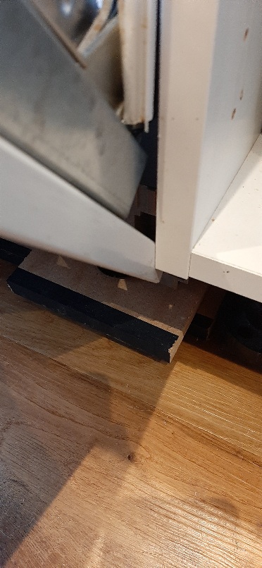

Just to show a couple of pictures. The are the bottom eject of the door touching the cupboards

I bought a dremel and routed out enough of the cupbaord wall to let the door open and close which is working well but I haven't quite finished it off. The chipboard is still exposed and needs to be covered over. Its a paint to move the dishwasher in and out and I didn't want to cause any damage by doing that too many times.
I bought some melamine (ebay) to try and stick over it but not quite got there yet. I still need to take a little more off and attach the dishwasher properly to the cupbaords. I was going to try and cover as much as I could with the melamine and get some waterproof wood glue to go round the edges and any exposed bits.
If I remember and get round to it I will take some pictures, it might even get me to finish the job off or at least move it on a bit.
I would say the dremel felt a little weak on doing a decent sized area and recommend only doing a few mm at a time to keep the wear down on the bits. The routing holder for the dremel is good but I found it moved a little and maybe a proper router would do the job much easier and better?
