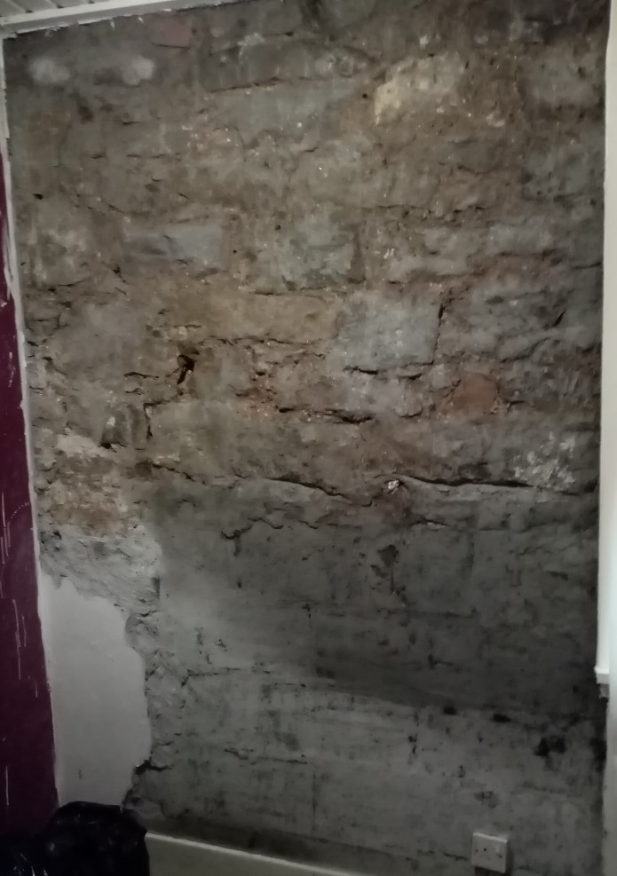

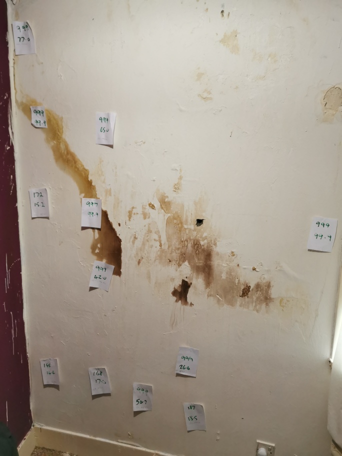

Having never done any meaningful DIY in my life I have decided to try to do a damp proofing job by copying the job spec I was given in a quote I got from a nationwide damp proofing firm. The job is to strip back the plaster on a 5sqm wall to the bare sandstone (which has a cavity behind it and then the main outside wall, which is also sandstone).
There is currently a bad leak from the roof that is coming inside the cavity and soaking the wall – it’s getting fixed as I write this though.
Soaking Wall
Soaking Wall

Step 1 – strip wall back to sandstone (already done – see below)
stripped wall
stripped wall

Step 3 – after roof is fixed, allow sandstone wall to dry for 3 weeks or so with the aid of a dehumidifier. Check moisture levels using the Protimeter Surveymaster I was talked into buying!
