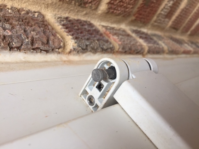

the pins in the door hinges of our exterior door are coming out.
The door was fitting about 4 years ago and moves effortlessly but I am a bit concerned about security, is this a sign that some tried to break in? (see attached picture)
Can I just push the pins back in by tapping them with a hammer? This is what I would do with a normal interior door but this one is exterior, facing our garden.
Cheers, Ole

by stoneyboy » Mon Jun 21, 2021 11:33 pm
Hi ole.st
It will be better to use a G-clamp to push the pin back in place, hammering may break the bottom hinge arm.
