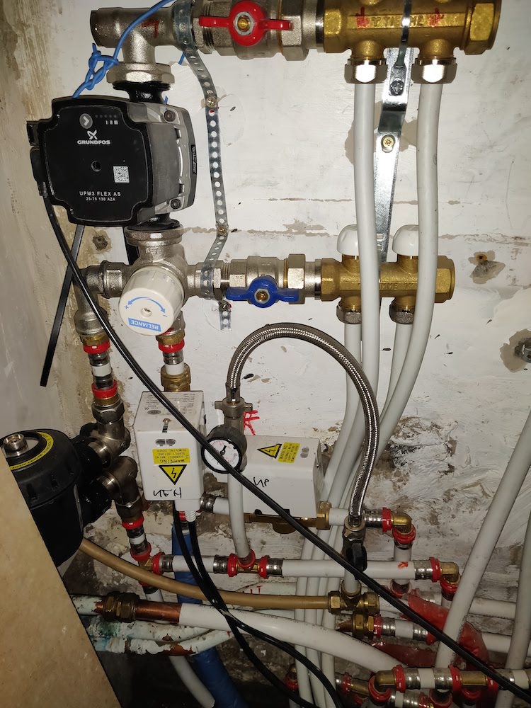

I am hoping to move and replace some radiators in my home, but first I need to figure out how to drain and refill the system.

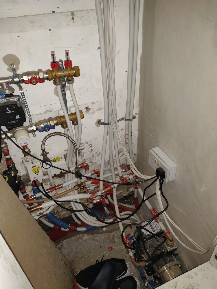

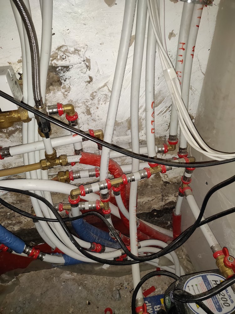

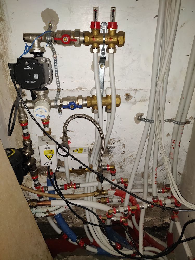

My home is separated into 2 zones - Zone 1 is the old part of the house, comprising a 3 rads on ground floor, 3 rads on first floor, 1 rad in attic conversion. Zone 2 is the kitchen - an extension which has underfloor heating. It is all heated by a combi boiler which is located in a cabinet in the kitchen. There is a 'plant cabinet' separate from the boiler, under the stairs in the old house, which is where the pumps and other things seem to run through for the heating. I am located in Ireland if that is relevant!
I am attaching images of the plant cabinet.
Could anyone help me with the process for draining and refilling this system? If there is any important information that I have left out, or if there are further images that would be useful, please let me know. Any guidance would be much appreciated!

Short answer - don't even try you'll have problems refilling the system.
General guidance assuming you do not have open automatic bleed valves in the system - turn system off, locate the filling loop, remove the mains connection, release the system pressure through the filling loop. Work on one radiator at a time, lowest one first, and complete relocation before doing the next one, you will need to deal with some water leakage.
When done re-pressurise the system and bleed, bleed, bleed.

When I say don't do it I mean don't do anything, do not move the radiators, stick with a working system.
Automatic bleed valves will probably be anywhere where the system forms an inverted U. Look for something about the size of a small brass tea cup with a plastic cap on top.
The filling loop may be a braided flexible hose under your boiler, one end will be the mains feed, the other will connect into the boiler system. The "nuts" are usually 2 spigot chrome fittings which you can undo by hand.
