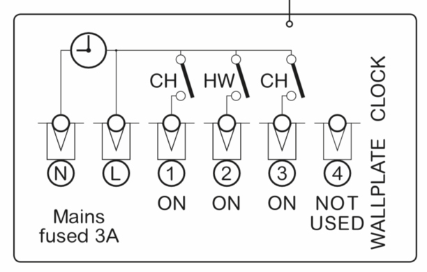

Although there is a standard back plate, there are three ways it can be wired, single, twin, and triple zones all use same back plate, and with the Drayton Wiser the OpenTherm option is an add on.
[attachment=1]triple zones.jpg[/attachment]
[attachment=0]temp2.jpg[/attachment]
So question one has to be is the boiler opentherm enabled?

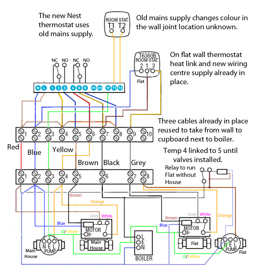

I am sure it is, however it is not as easy as saying put red wire here. I spent ages working out how to wire my Nest Gen 3 and ended up with this [attachment=0]C_Plan_My_HouseD-relay.jpg[/attachment] clearly yours will not be the same, but it took some time and effort to work out what was required.
