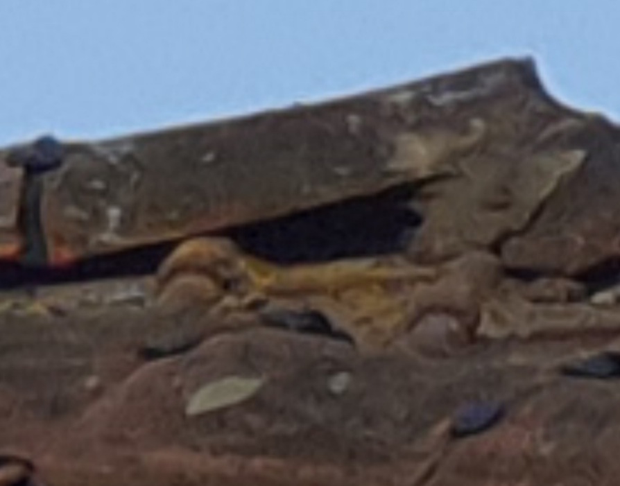

I would really appreciate help with this as well. Recently we saw a damp.patch on ceiling. We called roofer out and suggested we rebed ridge and hip tiles and some of the mortar was coming away. He asked what if we wanted mortar or dry installation. After researching we went for dry ridge system. However some of the ridge tiles are uneven some are higher than others. When we questioned about this he stated that the tiles were longer and a couple raised up when screwed in. It looks very unsightly but he stated that there would not be an issue with effectiveness of the roof. I hope.i can post pictures for you to see

by coulzee » Sun Jan 17, 2021 10:16 pm
Here is a picture of the raised ridge tile
Raised ridge tile
Raised ridge tile

by B4Less » Mon Jan 18, 2021 9:37 am
That is definitely and issue for sure. Water can easily get in under that ridge cap and if there is any break in the felt underneath you will get water ingress. you also run the risk of water pooling in low spots on the felt if there are any.
