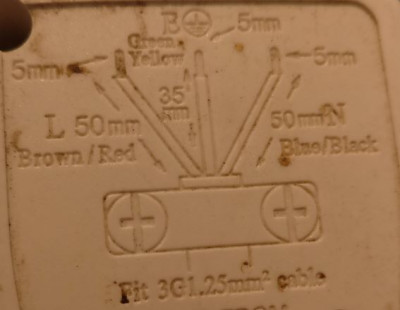

This is a photo of what it says on the back of the extension lead
Is this suitable to take some earth for the faceplate to the back box ?

Ah I see 5mm must be the length not the diameter, but it says 1.25 at bottom, so will this be ok?

If you look at the arrows, the numbers are adjacent, which means that they are the recommended length, not the cable size.
Yes you can use it for the EARTH, but not for anything else regarding sockets, as it is too small.
