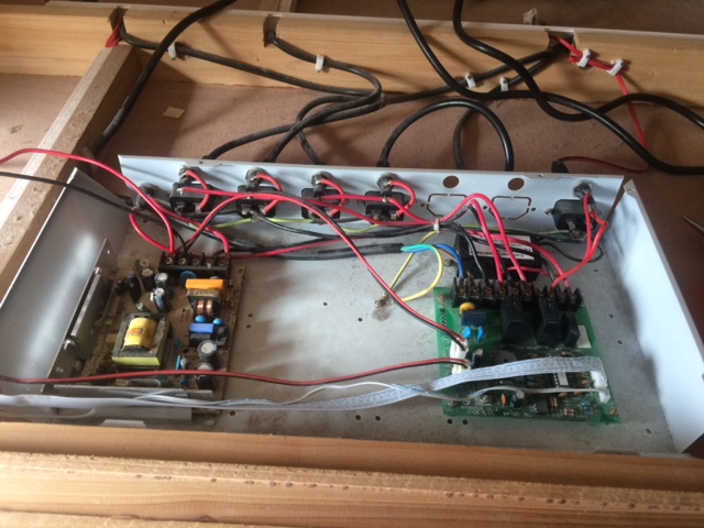

I purchased this sauna used a couple days ago, and its not turning on..
The previous owner sold it as having only an issue with the fuse, but I have exchanged all fuses, and Im assuming its one of the three components that are running in the rectangular unit mounted on top of the sauna.
I will post all the photos so you are able to see detailed views of everything - I have now ordered a replacement for the power supply (s-35-12) as I cant imagine the transformer would short the entire sauna. internal fuses are all 3 amp, this is the power supply (but the power running from mains is standard 13amp):
https://www.aliexpress.com/store/produc ... 13295.html
And from what I can tell there is a sort of voltage regulator on that PSU which has a phillips white screw which is used for adjusting. My guess is that previous owner set it for wrong output and it blew the PSU?

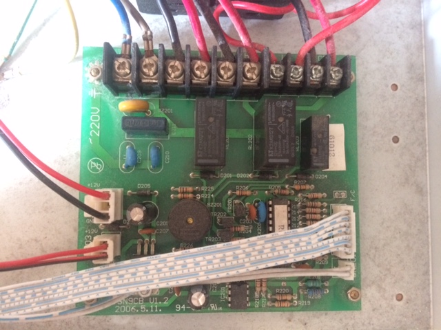

Alternatively there is the main board, but I wouldnt know what to look for, nor how to replace, as it had no particular model number.
I tested current coming from mains to the main board (sorry I dont have technical name for that) and electricity is definitely arriving there, but not sure where (or if) it goes after. I tried to swap one of the kettle lead fuses for the one on the PSU board, and then power on, but as soon as I tripped the power to on it blew the fuse..
Thank you for your help!

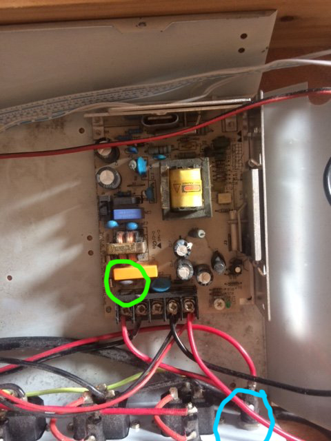

running more tests with new fuses, when all fuses are replaced and new, the one that continuously blows when I plug in is circled in light blue.
When that blew the last time it shattered the fuse and the piece circled in green sparked and a piece flew off the top of it, like a chip (see below)

It looks like a switched mode power supply, basic idea is the AC is turned to DC a capacitor charged then it's turned into high frequency AC so the transformer can be a lot smaller, if anything makes it so you don't get high frequency AC then the transformer becomes a dead short.
Posts: 2886
Re: faulty electrics in Infrared Sauna as it's not turning on
by ericmark » Sun Mar 05, 2017 6:01 pm
Sorry called away, in real terms it is very hard to repair a switched mode power supply, some times you can see an exploded capacitor, but 9 times out of 10 it's a case of renewing the whole unit.
