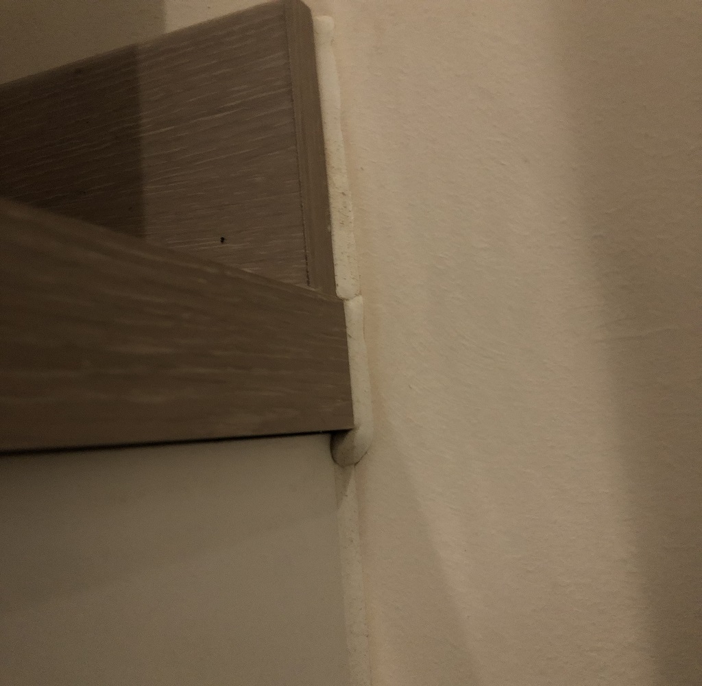

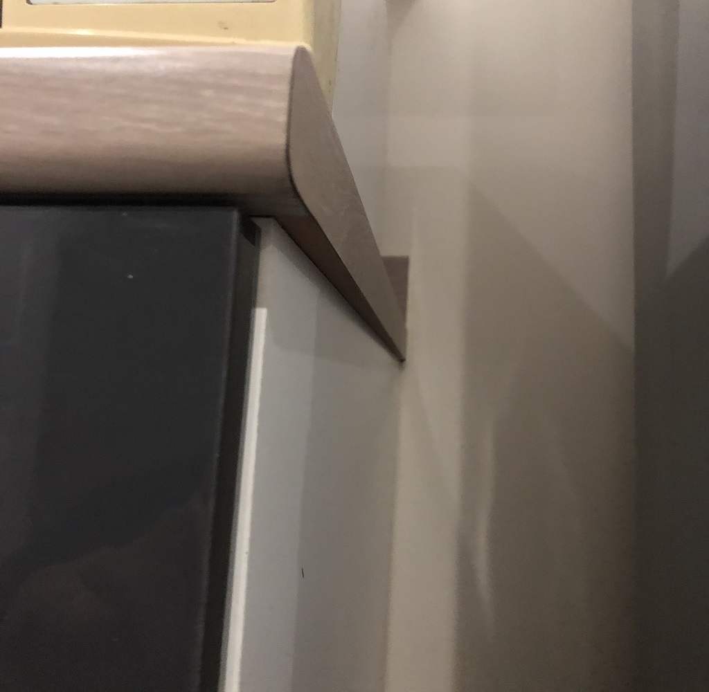

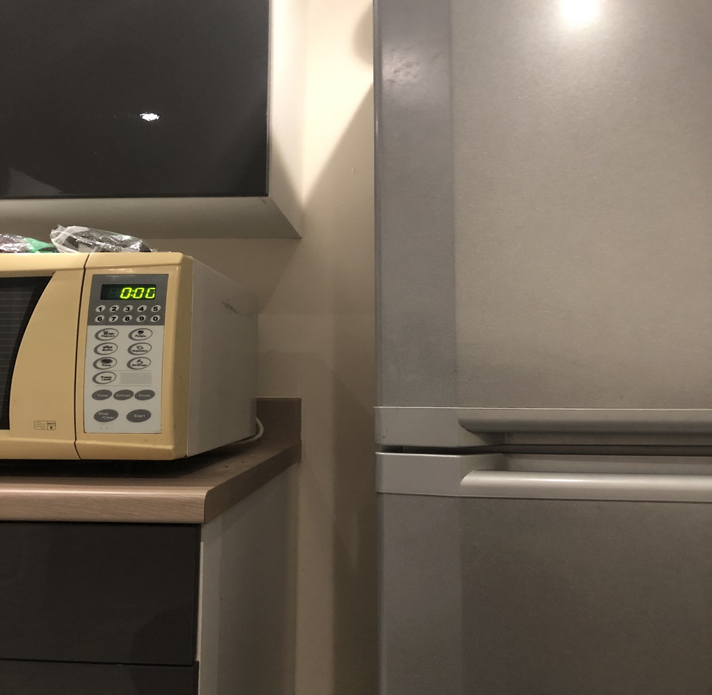

I am looking to fit a full length end-panel to my existing kitchen units in order to add a pantry/larder unit. The existing laminated worktop and the upstand overhang the base unit by around 10mm (see photos) which would prevent the end-panel to sit flush against the side of the base and wall units.
I was wondering what the best way is to overcome this issue?
Do I need to trim back the worktop and the upstand and if so, what is the best method to do that to get a clean cut?
I would appreciate if anyonw could throw some light on this please?
Posts: 6617
Re: Fitting full length end panel to kitchen units where there's a worktop overhang
Post by stoneyboy » Fri Jan 15, 2021 10:17 pm
Hi mech_man
You’re probably better fitting a carcass side panel to both the floor and wall units to overcome this problem.

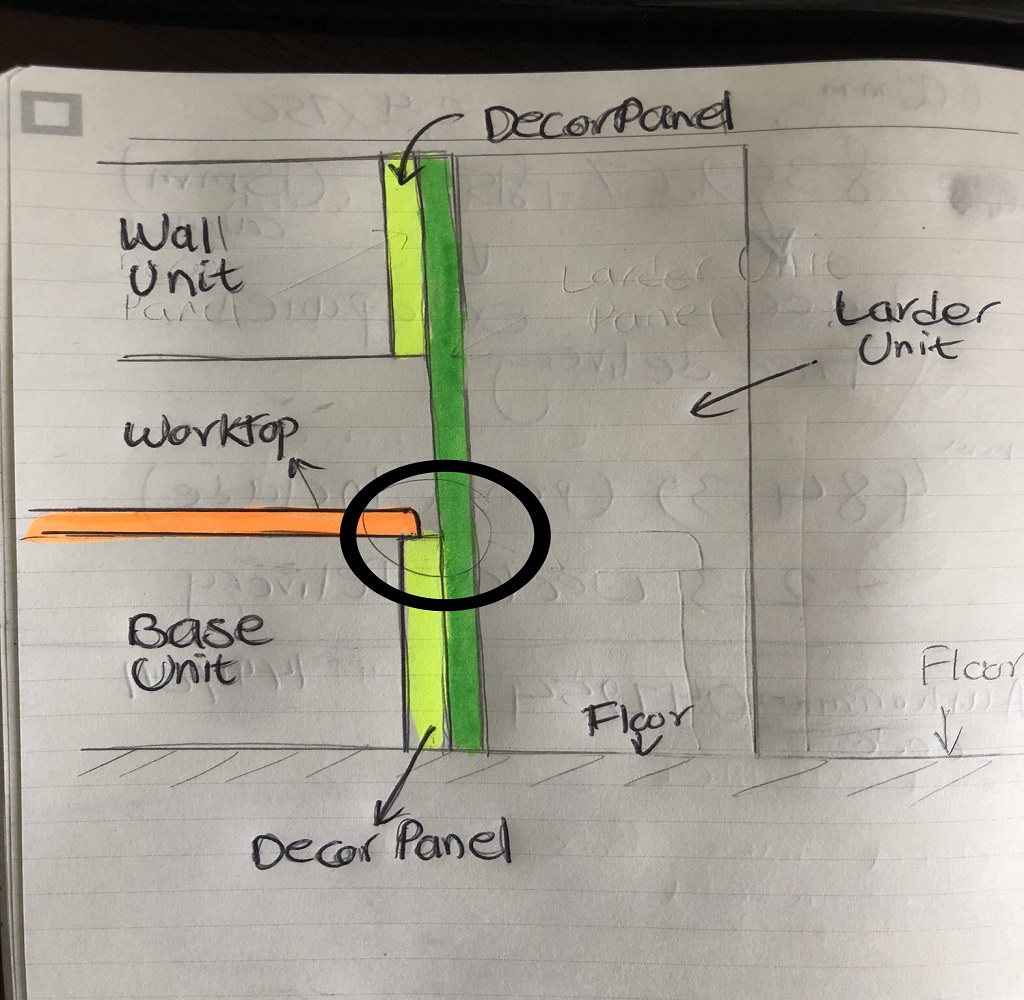

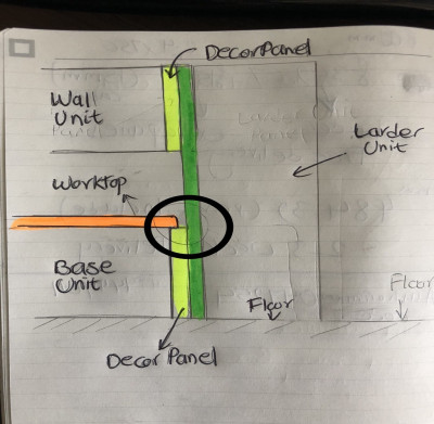

If I understood what you mean, By fitting a matching decor panel from the cabinet manufacturer (which is typically 18mm thick) to the sides of the base and wall units, There will actually be a gap of 8mm between the worktop and the side panel of the larder cabinet as I've shown in this sketch where I've circled in black, so I'm not sure if this would work?
Posts: 6617
Post by stoneyboy » Sun Jan 17, 2021 4:05 pm
Hi mech_man
Your images would suggest that the end of the wall unit is directly above the end of the worktop. If you have your larder unit carcase try offering it up and see how it looks, you will still have to fill in the gap between the base unit carcase and the new larder unit. If you are going to fit a decor end to the larder unit trim a narrow strip off the back (where it is below the worktop) and use this to fill the gap.
