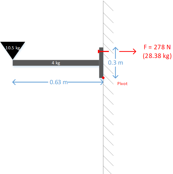

I am concerned that this puts a lot of horizontal force on the wall (equiv ~28kg).
Diagram
Diagram
The wall is a dot and dab onto aerated concrete blocks (H+H Celen Blocks Standard Grade (https://www.hhcelcon.co.uk/solutions/by ... con-blocks)
Will the wall support a 28kg side load? The TV stand says it will support TVs up to 25kg, but even with a 11.5kg TV, it seems like when I hold the TV stand up with TV, this feels lie it will put a large load on the wall. Any advice would be very welcome.
