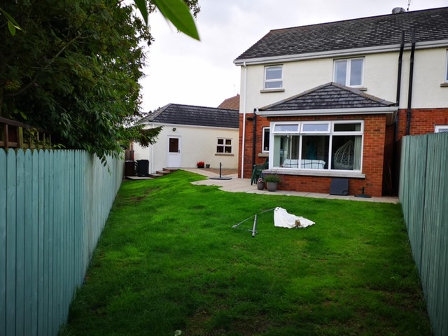

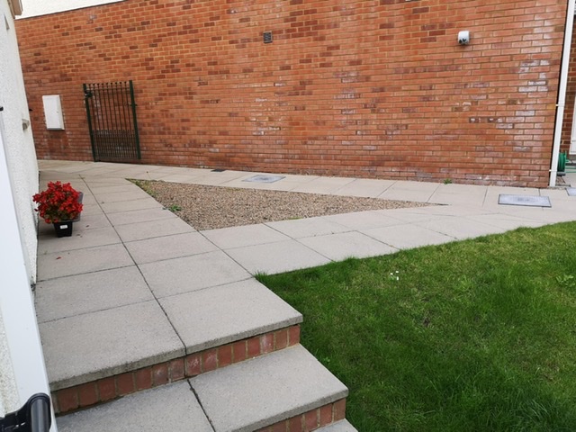

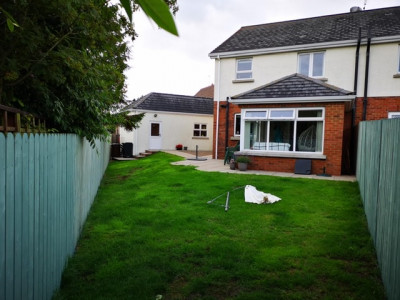

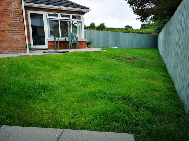

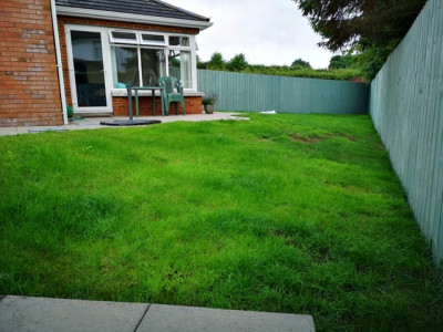

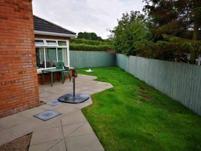

Hi all, first time on the forum. Hoping I could get some guidance. I am currently reviewing the option of renovating my rear garden. We have a young daughter and would like as much of a flat garden as possible but not to sure on how to achieve this, hence why looking your guidance.
See attached images of current garden. Note the level change is very steep in some locations.
We have had a few contractors out to review, and they all have the same solution. Install a retaining block wall along the fence and infill with soil. My only worry is that it may not end up that level. Also, the top of the boundary fence will not be about chest level.
Any ideas would be much appreciated.

No way could I make the garden here flat, would not try, but in my first house I did try, built a wall at the back and put pipes in the wall so it would not build up water pressure behind it, so would be safe, then neighbour blocked them up.
I note here the gardens have a small gap between my wall and neighbours fence, it would not matter we do get on, but any wall can over time fail, and what you need to consider is what will happen when it does.
From what I was told it does not matter if a neighbour blocks drain holes, it's your wall it must be made safe.
The one between us and next door seems to be 2 foot thick concrete, and it is only about a meter high.
