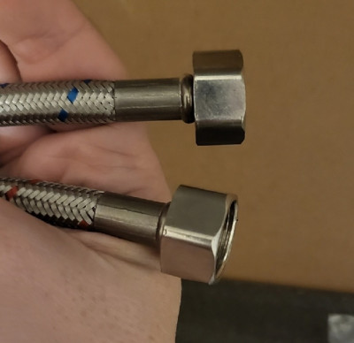

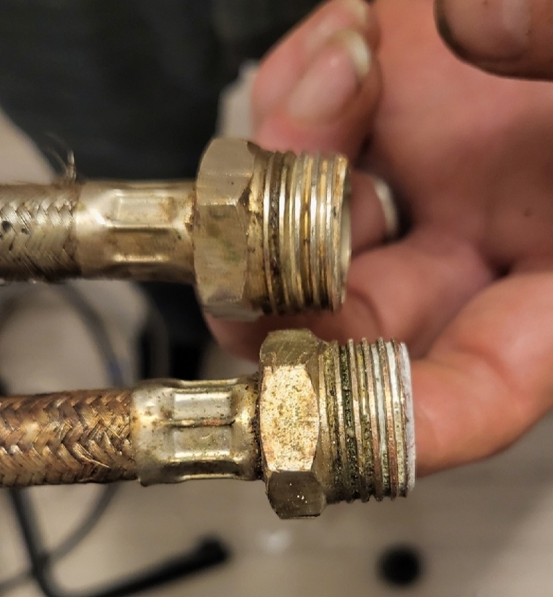

Can anyone offer me some advice on my kitchen tap replacement project.
I have different fittings on my old tap and my new one. I'm hoping there's an adapter I can get but I don't know where to start. The hoses don't come off the new tap so I've no option to change those.
New fittings
New fittings
Old fittings
Old fittings
Posts: 6608
Re: Flexi hose adapter for kitchen tap replacement?
by stoneyboy » Fri Mar 18, 2022 10:11 pm
Hi katmcleod,
Difficult to tell from your photos but you probably need a 1/2” BSP male to 1/2” BSP male adaptor. If this isn’t big enough exchange for a 1/2 x 3/4 adaptor.
