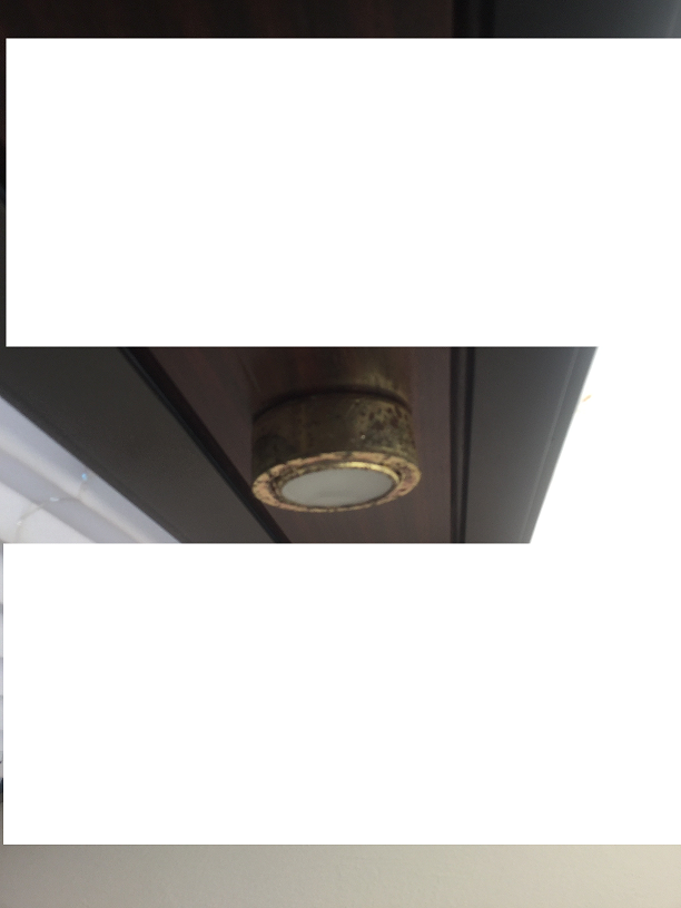

Hello,
I normally dont have issues replacing spotlight bulbs (novice when it comes to DIY). However the spotlights in conservatory are problematic, out of six spotlights four are now fused.
I cannot work out how to get access to the bulbs so they can be replaced.
I didnt want to break it so not been very forceful - couldnt see any clips
I posted a picture to help you visualise the light
Any help would be most appreciated.
Thank you

Yours look a bit tired, why not buy a new one (or more) and see how it is assembled?

Many lights today do not have replaceable bulbs.

10 years ago most spot lights were quartz, and there were two main types that fell into the MR16, the G5.3 and the GU10, the G5.3 was normally held in with a large cir-clip, and the GU10 you twisted often using a suction cup on the glass to twist it. There was a slightly larger version called a GX53 but in most cases you could remove the bulb.
But when the LED came out with a expected 10 year life, we started to get fittings where you can't renew the bulb, there was an EU move to stop these, but we left the EU.
In some cases it did make sense, I have many times struggled with a outside spot light and just come to the conclusion only way is renew the whole thing anyway.
I agree with Mr White seeing how the new one works can help, but only if you like the old one.
