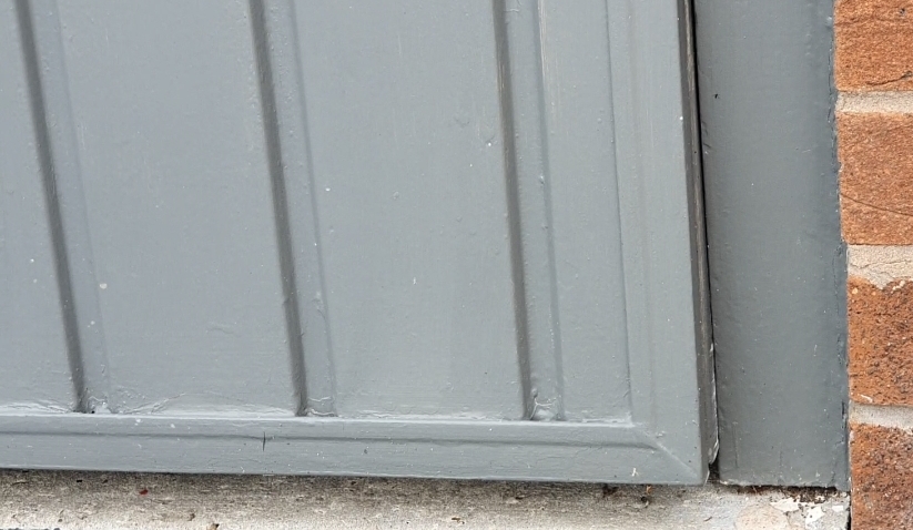

I have a Henderson Premier garage door which is catching on the bottom right frame when it closes as shown in the photo.
I noticed the cable on that side is much tighter than on the other side. It only has one nut on the overhead spring that can be tightened on the left and I am aware it is dangerous to do any work to it without properly securing it.
However is there a way to change the tension on the cable just one one side rather than changing the tension on the spring itself?

Rather than cable tension it is more likely that the main hinges brackets have worked loose and dropped.

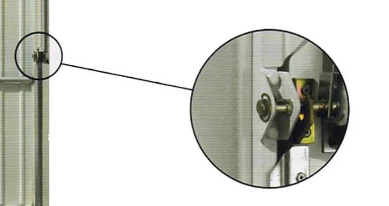

Its a canopy door, which is kind of up and over but not the specific up and over type. I have attached two images of the cone at the top and the bracket the cable connects.

Sorry got the images the wrong way around

Thanks for the photos. They show that the cable is no longer in the grooves - they are supposed to be nicely following the cone taper.
You could try refitting the cable which is best done with the door on the up position. Use mole grips to take up the spring tension and relocate the cable into the grooves. Copy the opposite end so you know where it goes.
You may have to fit new cones and cables if either are damaged.

The photo was just taken off google images to show a like for like one, sorry!
The cable itself on my garage is wrapped on the cone without any issue. Just wondering if there is a way to tighten one side of the cable without tightening the spring itself
