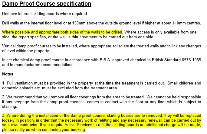

This is the first issue I have posted on here and I need advice on what you make of this professional company's workmanship in installing a injection damp proof course, I am certain it is done wrong and I am shocked. This company I wont name as of yet is a member of the PCA(Property Care Association). Can you please read below email I have sent to company and look at pics attached and please comment on your thoughts on this work. I think it is shocking but the company is saying it is good. I dont know what my next step or plan of action is. Please Help.

I dread to think what the depths of all of the other drilled holes are. Meaning the inside where the serious problem with salts and damp coming up the wall in the kitchen and front room has not been drilled into to fill with injection cream. In the specification you sent me which I have showed a screen shot of you say you would be injecting from both sides. The inside wall is the most important to be injected as of the salts and damp coming up the wall.
SEE DPC SPEC IN PIC ATTACHED

This is a screenshot of part of the Injection damp course specification which states the injection damp course will be drilled and injected from both sides of the wall. I cannot understand why they have only injected from the outside cavity wall and not even penetrated all the way through.

That does not look like a cavity wall,just a very badly built wall.hopefully 9inch.
In that case you dont need to inject both sides of wall. In norfolk to treat internal
side of the wall the wall is required to be stripped of all plaster and render a metre high including taking off all skirting boards.It will take time to know if things have gone right.
