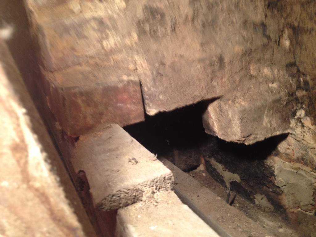

I've got a damp problem that we can't quite work out the solution to.
As you can see in the image below it's near the ceiling, though appears as a patch slightly below (the screwdriver stuck into the ceiling is for later reference in a another pic).
There is a chimney resting on a joist in the loft that's roughly above the wet patch that's open from below and it wasn't in great condition. However, we've repaired the chimney and the problem still remains.
Our next thought was that it could be leaking through the parapet, running down the cavity wall, hitting a wall tie and coming across. Our plan was to take a chunk of the wall out so we could see what's going on behind. However, we've now realised that it's a 9 inch wall (this is a terraced house), so there's no cavity for it to run down.
Basically, we're at a loss into where this water is coming in and why it's showing up here. Any ideas would be greatly appreciated!
Below is a picture of the loft with the screwdriver sticking up from below, but I'm not sure this will help.

the water is coming down the flue, its either penetrating through a crack or the brickwork.
Secondly its structurally unsound to have a chimney stack resting on a floor joist, it is not designed to take that much weight, and in time water will rot the joist inevitably causing collapse
