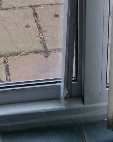

Post by Kellymary76 » Sat Feb 22, 2025 6:35 pm
Does anyone know what this part of a sliding patio door is called trying to find a replacement part but can't find what it's called. Any help appreciated

Hi kellymary76,
You would need to find something like a side trim/finisher for a fixed panel.
Unless you can establish the manufacturer of the doors you will find it very difficult to match the existing one.
Why do you need to replace it? It should push back into place.

Post by windows_solutions » Mon Jun 02, 2025 4:36 am
From what I can see, this looks like it could be either a roller assembly or a track guide for your sliding patio door. These parts commonly wear out over time and can cause sticking or misalignment issues.
If you're unable to find an exact replacement part, or if other components are also damaged (like the track or weather stripping), it might be more cost-effective in the long run to consider a full sliding door replacement. Newer models operate much smoother and offer better energy efficiency and security.
