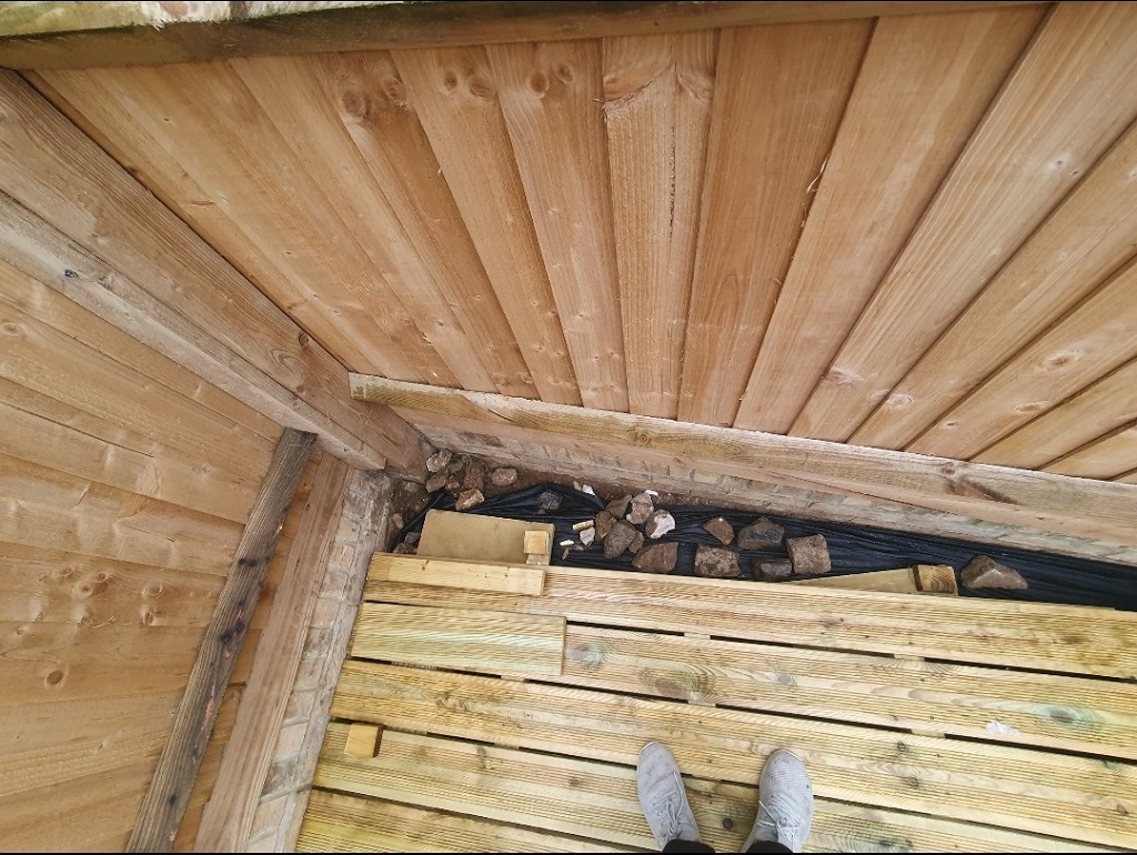

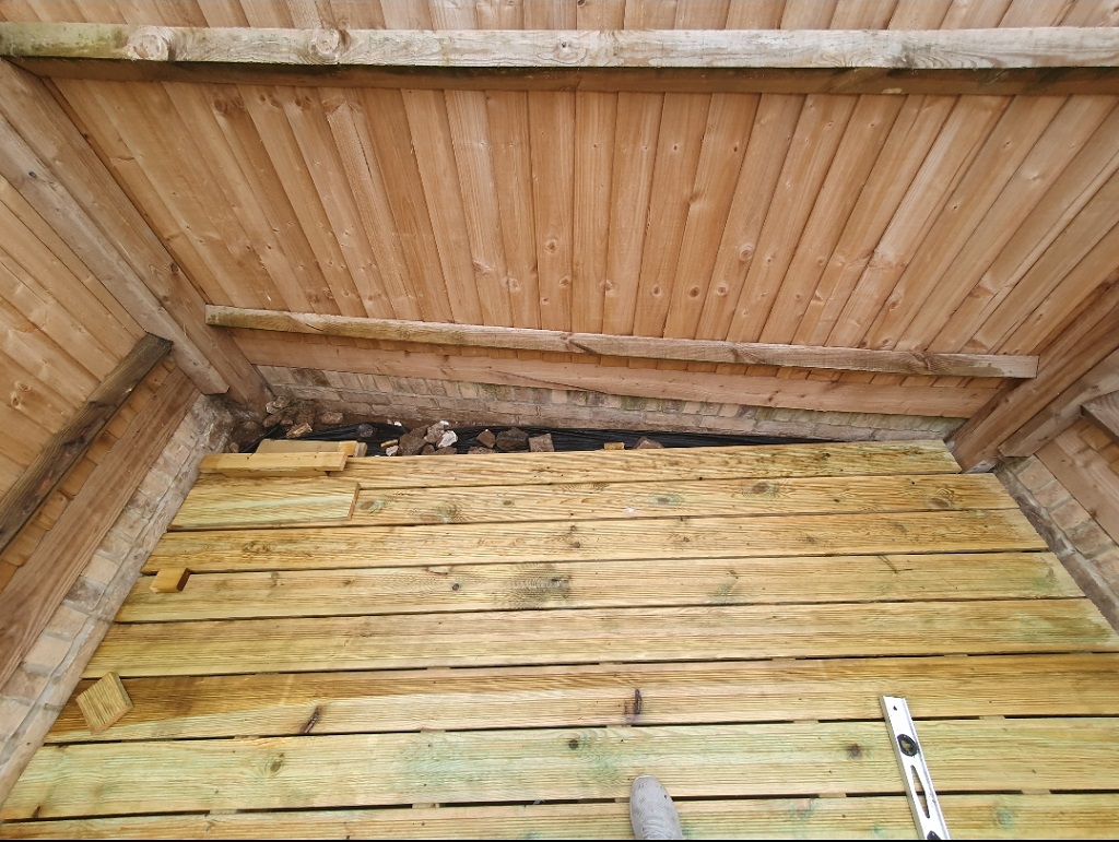

hello everyone
i recently had an awful experience with a bit of a cowboy. ive been left with an awful gap at the rear of my decking and im unsure how to fix it. he suggested filling with stones and flowers but that isnt an option. i just want it fully decked , can some geniuses PLEASE help me with a solution.
Re: Help Needed With Gap at Rear of Decking
by stoneyboy » Sat Jul 16, 2022 10:25 pm
Hi squall32000,
You will have to slide some mini-joists in the gap and rotate through 90deg.. screw down through the existing decking to secure the mini joists. Cut a length of decking to suit the gap and screw down into the mini joists.
