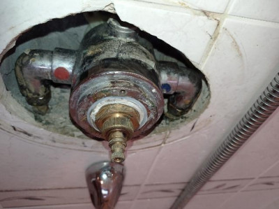

Hi, looking to identify the shower on attached pics, running lukewarm and suspect the cartridge, thanks

Your shower looks like a Mira excel biv, but you will only be able to confirm this by finding a makers name or part number. If you are able to do this it is only the start of your problems - these valves are notoriously difficult to take apart especially removing the large central body.
Replacing the whole valve will also be difficult but if you go for the same design choose one where the inlet centres can be adjusted (slightly).

Thanks for the info, I tried to get the centre out today and it comes out about 20mm then sticks, there are no markings anywhere I can see so going to try to get a replacement as you suggested. Thanks again

If you try turning the centre too hard you may damage the pipework in the wall.
I find the best solution is to fit a bar type mixer with a flexible to the shower head but it does mean replacing a couple of tiles.

Hi Stoneyboy, thanks for the advice, I'm going to do as you suggested and luckily I have spare tiles, thanks again
