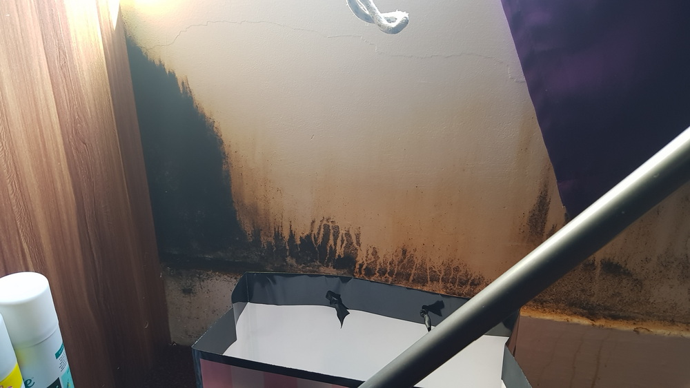

Every year during winter, two walls in one bedroom in my 3 bed end-terrace house is covered in black mould. These wall is the end wall of the house and one of the outer walls is facing an vast open area with no tree or houses. The other wall is facing the street.
Summer is not a problem as I can open the window but winter is really bad. The heating is on and the house is warm. However, as it is a small house and we dry the clothes within the room, condensation happen and it is not easy to get rid of that.
I attached here some photos for your information. Could you please advise the terms of the issue that I am currently having and how to fix it? If it require professional help, please point me to the right service?
Thank you very much,
Johnny
Wall
Wall

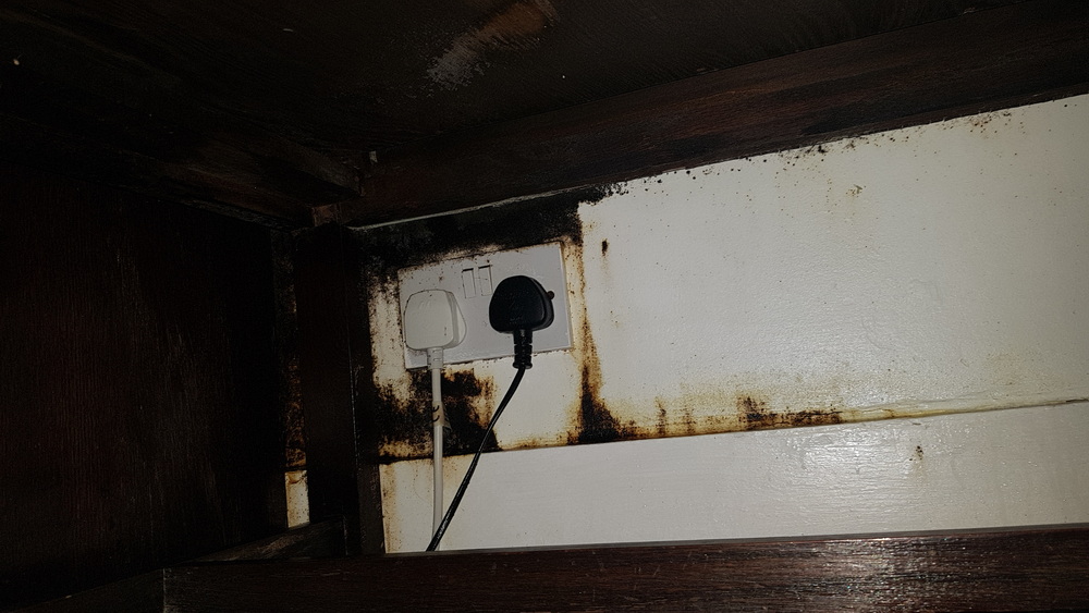

Behind the cupboard
Behind the cupboard

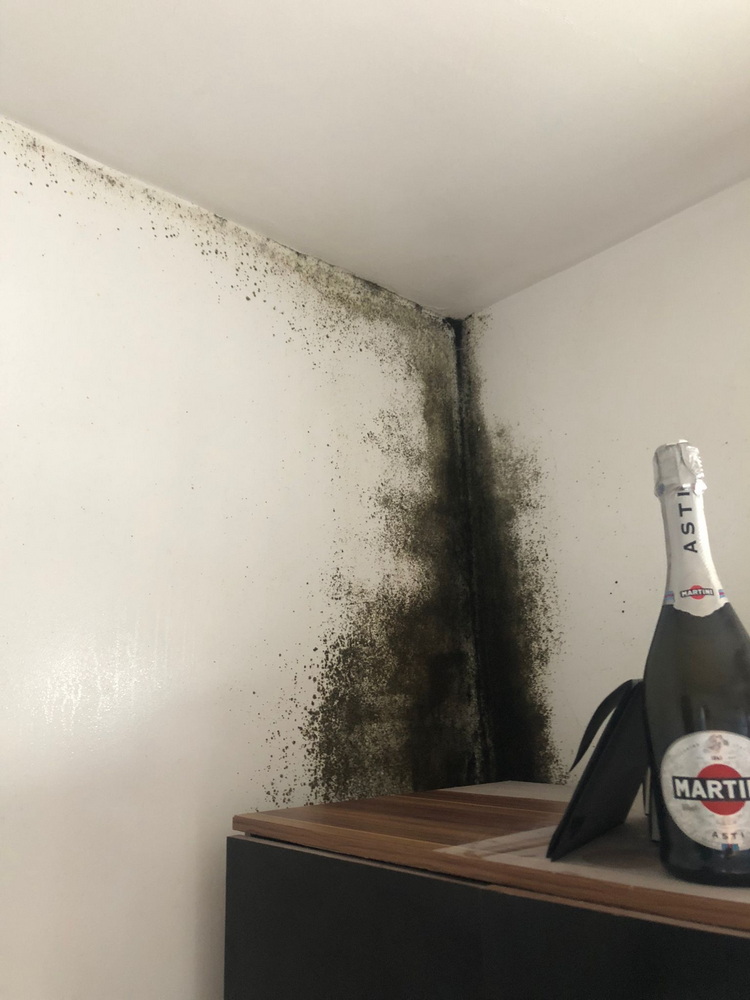

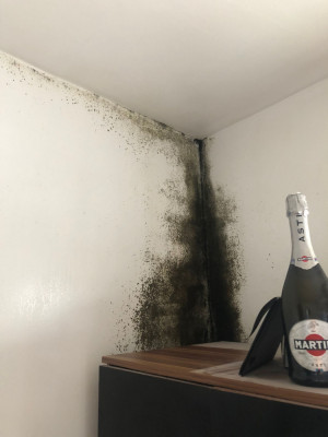

Top right corner
Top right corner

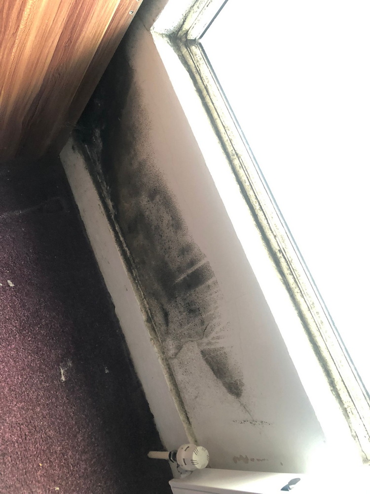

Bottom right corner, facing street

Re: Help with damping and black moulds in my bedroom
by stoneyboy » Fri Mar 18, 2022 10:02 pm
Hi duongnt,
Given how you are using the room a de-humidifier may be your only solution. Pick a smart one so that when humidity is under control it can decide how fast to run.

by duongnt » Sun Mar 20, 2022 10:01 pm
Thank you, let me try that out for few weeks
