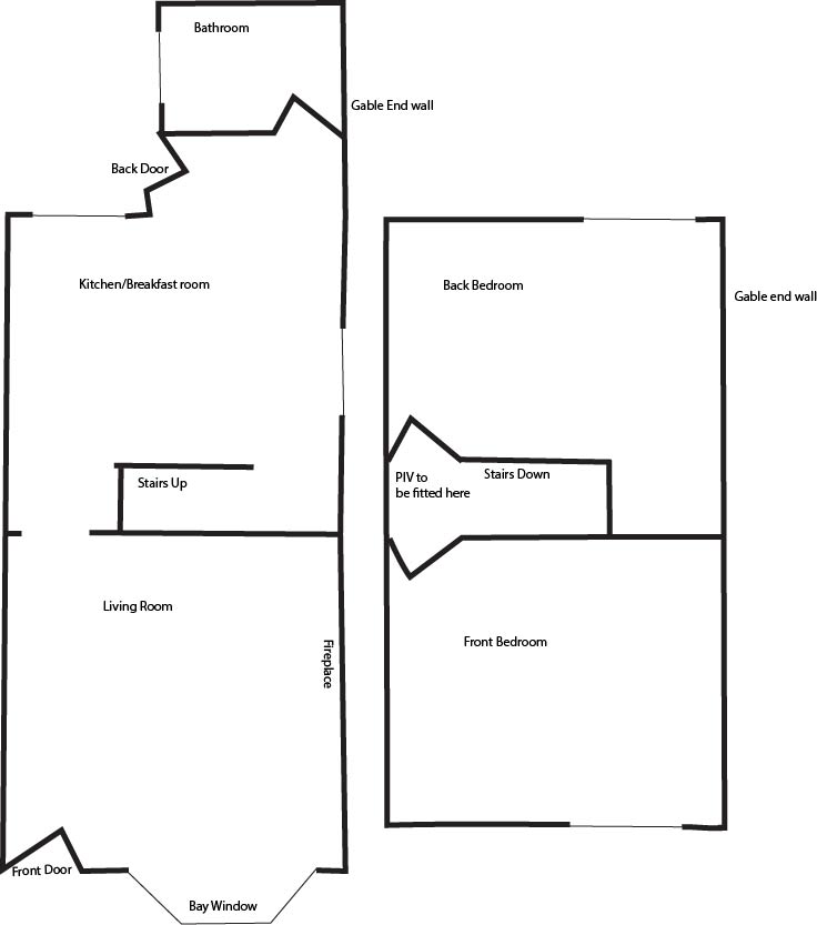

I have attached a roughly drawn a floor plan
Hoping to get this sorted asap so thanks for any help!

The fact that you live remotely means you are very much in the hands of your letting agent and their contractors. Your April 23 letting agent seems to have a more realistic assessment of the damp problems.
The original DPC contractor treated the party and gable walls in the rear room and your letting agent thinks the gable wall is dry behind the dot and dab boarding.
I would suspect a lot of the damp problems in the rear room are as a result of the two moisture creating activities ie bathroom and kitchen, being in this area.
If you do get a building surveyor in make sure they are aware that the with the exception of the rear kitchen wall all other walls have had a DPC installed.
