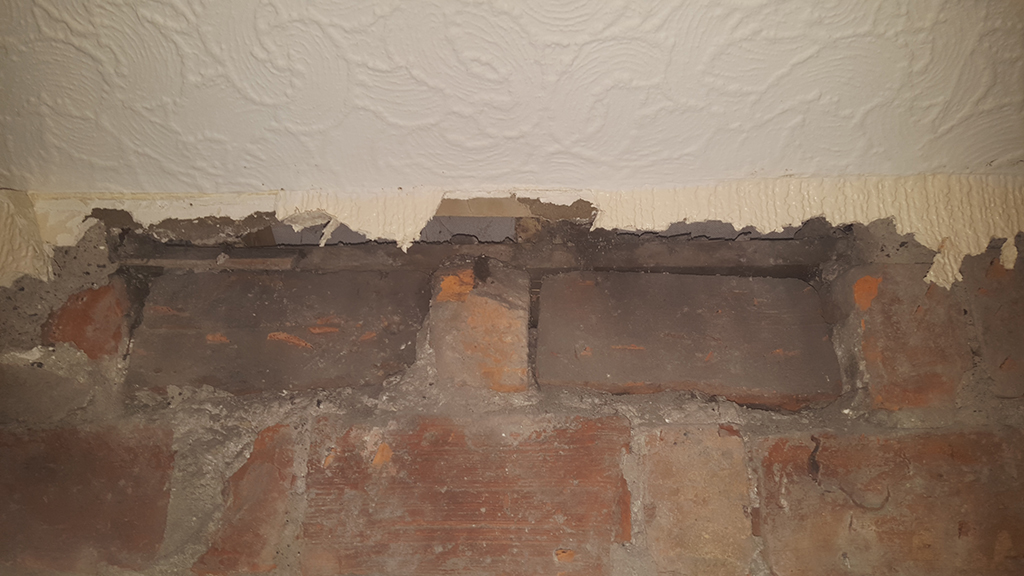

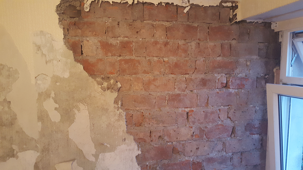

I'm working on one of my upstairs bedrooms and removing the old mortar plaster from the wall before I batten it and board it.
I'm doing this as a tiny shelf pull a massive part of it off already so I want to get rid of the old plaster.

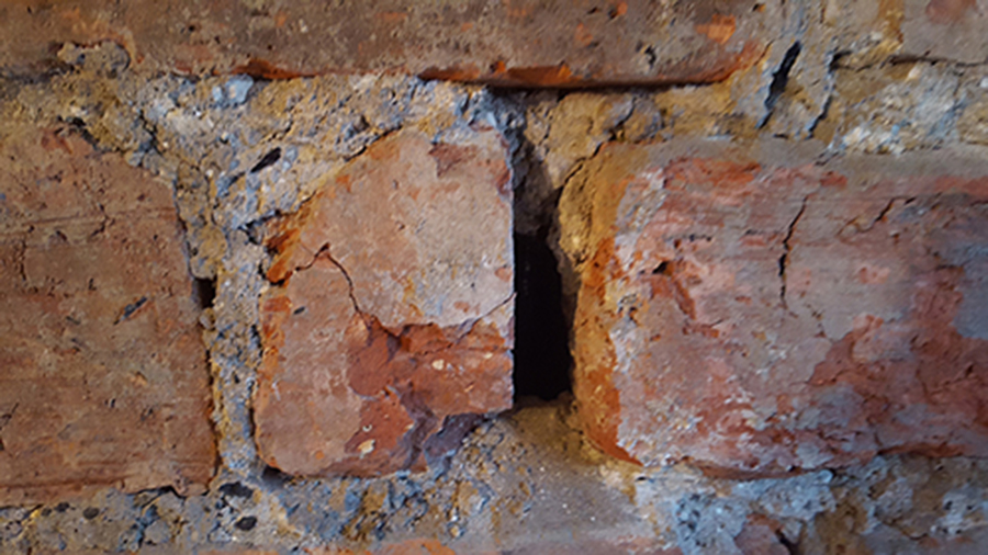

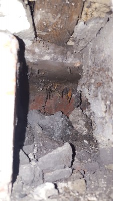

However on hacking away some of the plaster so far, I've found a lot of gaps between bricks and also some loose bricks.
What is the best course of action for me now, I'm more worried about the wall structurally. I believe this is a double skin wall with other bricks on the outside as I can see some through the holes..
Can anyone offer any advice before I get a builder to look at it.

this is not uncommen in older properties and if the wall is dry just make good with lime motar.
