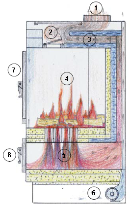

There are some very cleaver wood burning stoves, [attachment=2]Hughes Condensing Stove 2 small.jpg[/attachment] this seems a really cleaver system, a condensing wood burner with plastic horizontal flue, I was interested so wrote to them asking what was done in the case of a power cut, no reply, [attachment=1]wallnoefer.PNG[/attachment] this is another where it seems the manufacturer has blinkers on, and has not considered a power cut is possible, I remember the days of coke burning fires and dropping the fire bars and dragging the burning coals out of the stove onto a shovel and carrying out side, lucky quarry tiled floor.

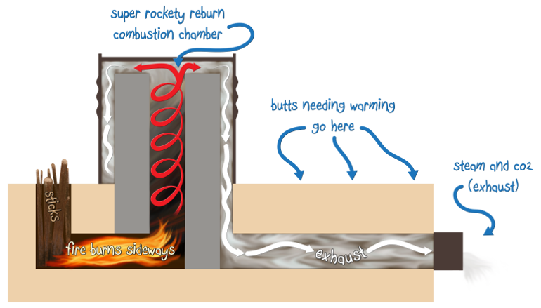

[attachment=0]rocket-mass-heater-diagram.png[/attachment]This heater is used a lot in other countries, it is made with an oil drum stone and concrete there is in essence nothing to burn and a very good system, I had a friend who was interested in natural forest practice and wanted to install one, but he got a resounding no from his insurance company, even if in real terms safer than what he already had.
