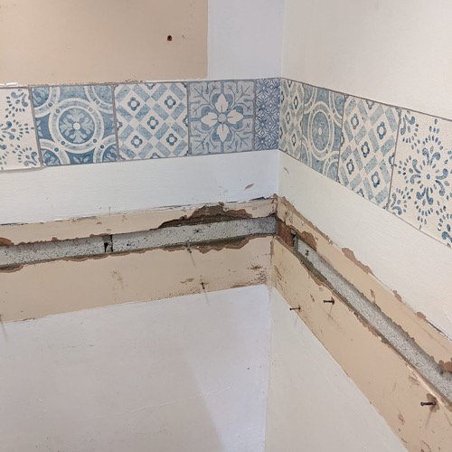

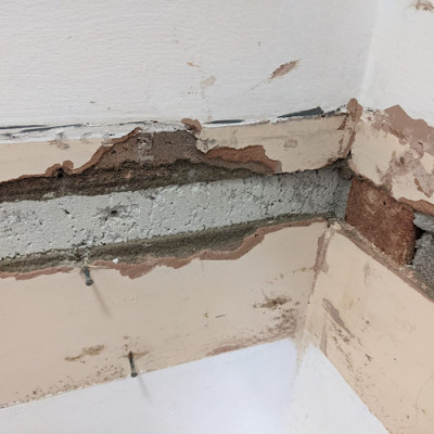

I am useless at DIY so very glad I have found this forum. I have a small outbuilding which had an office in it. I want to change it into a storage room with metal racking in it. There was a desk attached to the wall with some skirting above the desk and on removal I have found that the skirting was hiding some holes!
I was wondering what the best way to fill this strip would be. I am hoping to just sand down and paint over as it will be behind the shelving!
Any advice greatly appreciated!

Hi sorus5,
Probably best to buy some one coat plaster and use this to fill the channel.
