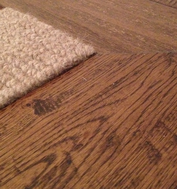

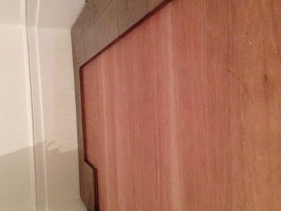

I have attached 3 images, 1 showing flooring laid down around perimeter of room and second with a carpet sample, using a crumb underlay (this is the type of finish i want to acheive). As i understand it the carpet sample shown on image has some type of glue put on all 4 sides to prevent carpet fraying.

The only thing to do is talk to the carpet supplier about what can be done to the edge to stop it fraying. Another time it would be btter to lay the carpet first, then rebate the underside of the internal perimeter boards so they overlapped the first 15mm of the carpet without compomising the finish.
