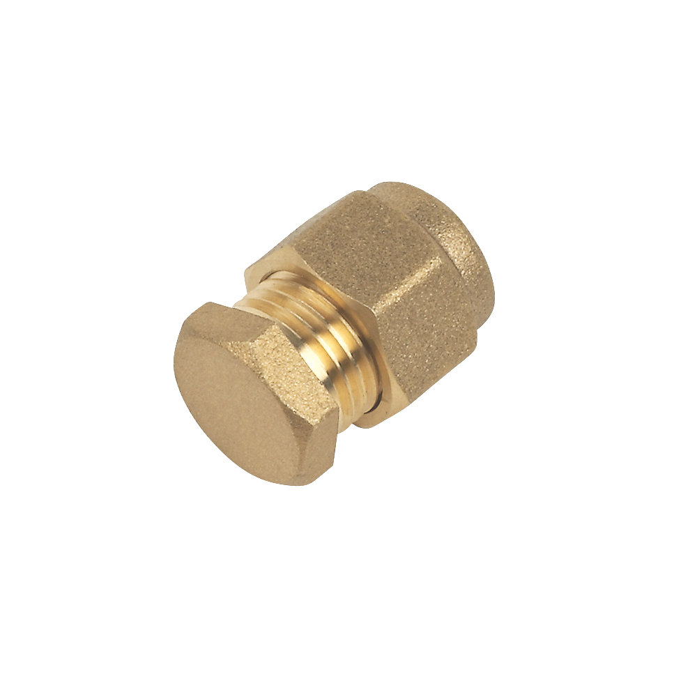

0.99p from Screwfix
0.99p from Screwfix
Did you cut the pipe with a hacksaw or pipe cutters, ..? hack saw leaves a very rough cut which is never very square and clean,
However best fit a compression end cap, (0.99p from screwfix) (15mm pipe normally for a sink) easy to fit, just need 2 adjustable spanners or 2 pipe grip wrench,
Clean the end pipe remove any paint, slide on the compression end cap make sure there is an olive inside the compression end cap, using the 2 spanners or grips hold one end and tight the other end. and you done, should work a treat. if it still leaks you can open it up again and put some PTFE tape in the pipe and retighten, you should be good to go.
