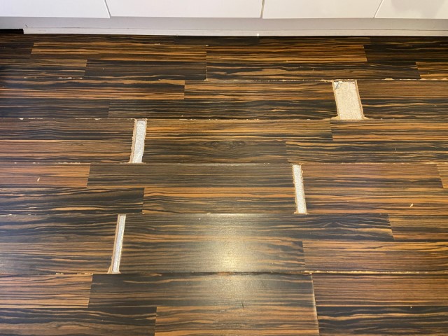

Hello,
The laminate flooring in my kitchen keeps moving. I can kick it back into position but I was looking into ways to stop this from happening.
Please see image attached.
Any suggestions?
Thanks in advance.
Re: How to stop laminate flooring from moving?
by stoneyboy » Sun Nov 12, 2023 10:52 pm
Hi ambrozote,
The interlocking ribs have been broken during installation, try using mitrebond along the join, push together and spray with accelerator.
