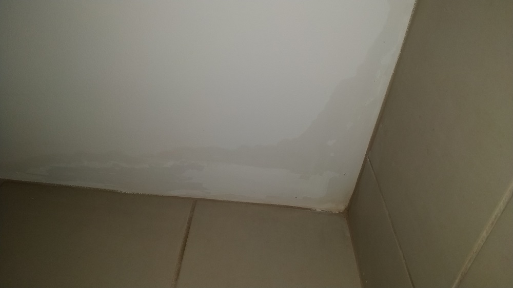

Here is a picture of the bathroom ceiling:

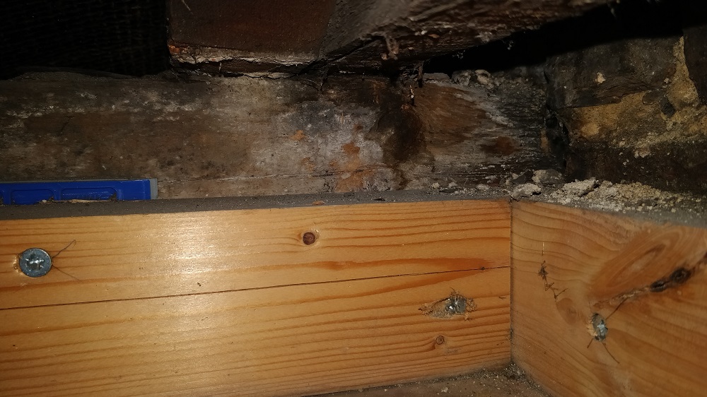

And here is a picture from the loft where the water was working its way from the brick on the right, through the old timber wall plate onto the plasterboard below:

Stick with your pin damp meter. Check away from the damp patch and you should find a low reading, plot the edge of the area where you are getting full scale readings and over time see if this reduces. If not you have not solved the problem.

Thanks stoneyboy. Actually drawing it out on the ceiling is a really practical solution I had not thought of!
Any views about how long it should take to dry out naturally? Three weeks sounds like a long time but it is a bathroom and I understand plasterboard can soak up a lot of water.

It wouldn’t surprise me if it takes 3/4 months if you want it to dry naturally. If you have a heater in the bathroom leave this running for a few days and see what effect this has. Bear in mind that the dampness will be self sustaining - a damp ceiling will be cold due to evaporation but the cold will lead to condensation.
