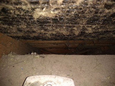

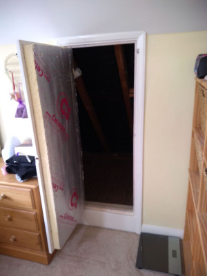

Thanks for your help. The ceiling, sloping bits and walls all have 100mm rigid insulation. It is the floor void I need to sort. So, I can seal them off, they don't need ventilation? And whether I can close off the eaves from the roof? The draughts are impressive. A few pictures to demonstrate. They're in reverse order but you get the idea.

Re: Insulation in 1970's Chalet-Style House
by stoneyboy » Sun May 17, 2020 10:55 pm
Hi JonThompson,
You must maintain ventilation of the area between the rafters i.e. below the sarking felt and above the plasterboard. You can seal the area between the dormer floor and the ceiling below it. The simplest way would be to seal the ends of this area working within the crawl space and pack loft insulation in the ends.
This is always a difficult one when done retrospectively but unless you do stop draughts you will have a cold floor in the dormer room and a cold ceilings in the rooms below.

by JonThompson » Wed May 20, 2020 12:52 pm
Hi, im going to see if I can drop the pvc soffit down to access the void from outside, might save my knuckles! Thanks for your help.
