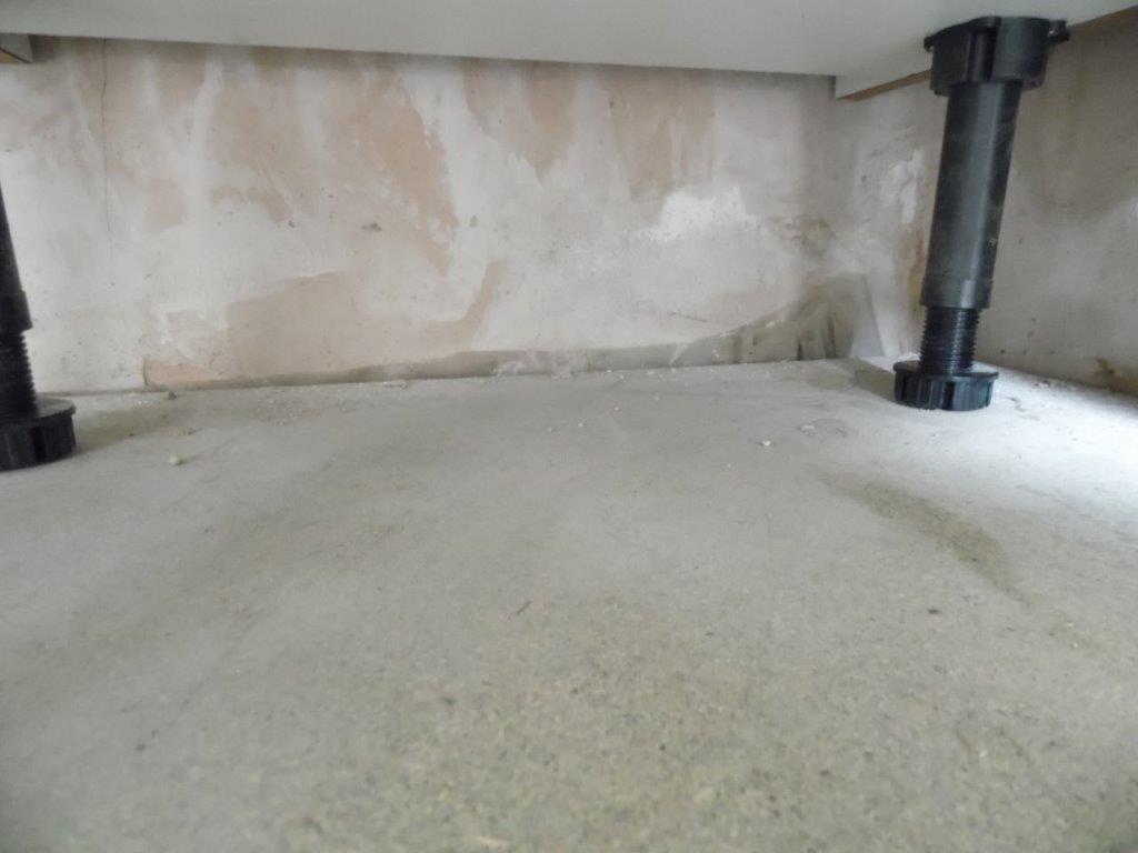

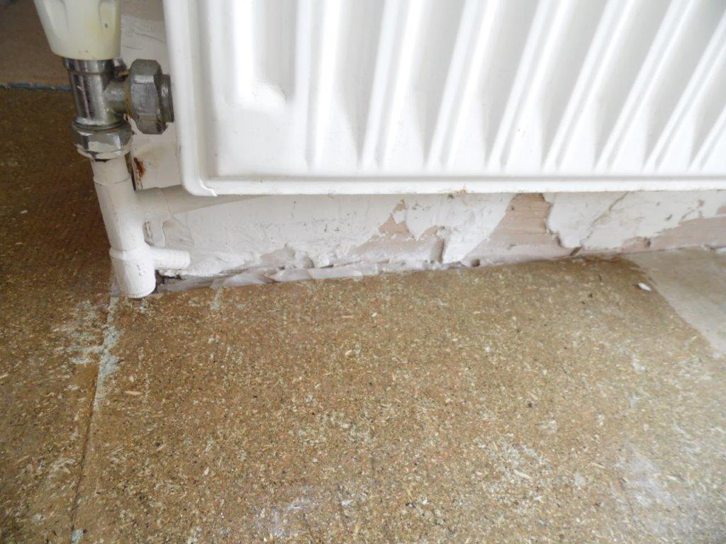

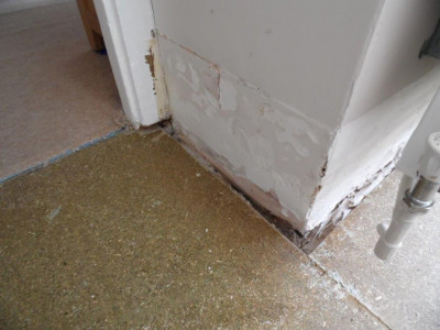

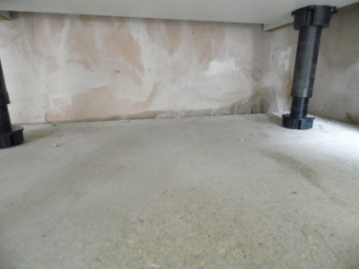

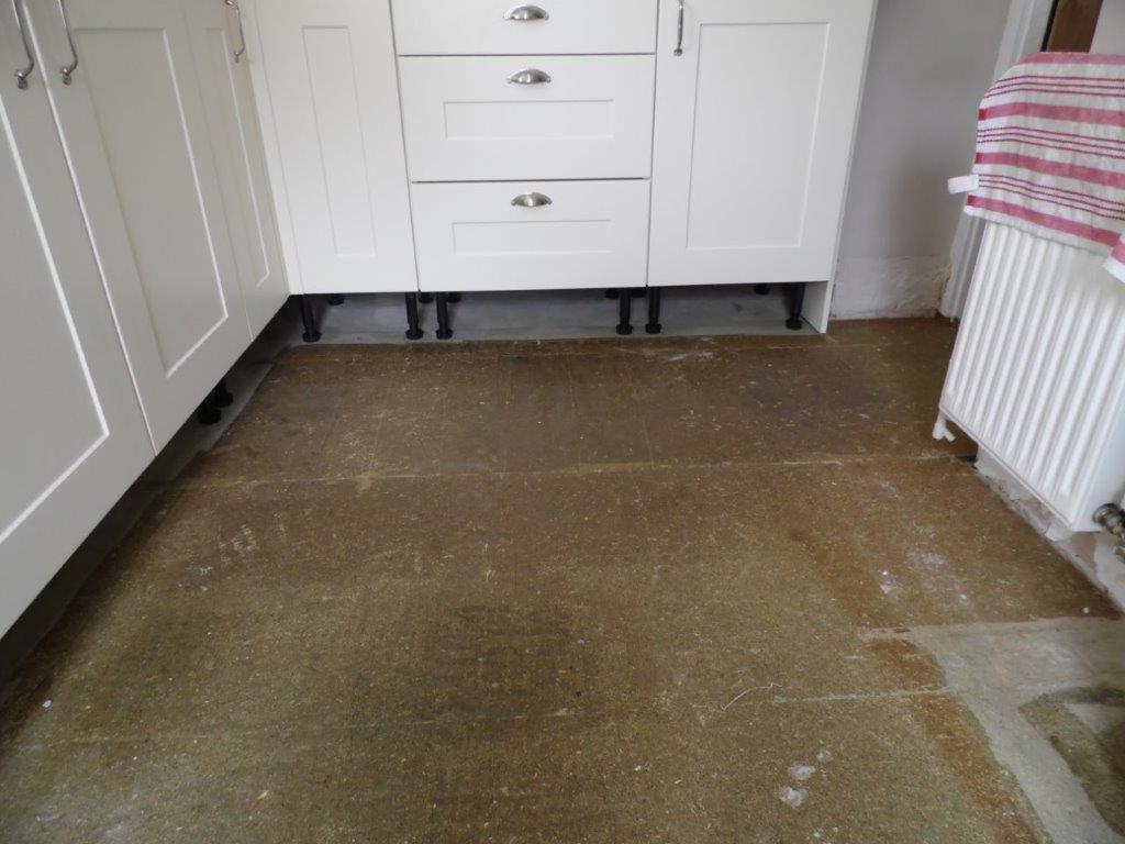

We wish to lay a suitable laminate floor over a fibre board underlay in our kitchen. We have removed all of the old flooring to reveal bare chipboard flooring.
As the house was built circa 1840, there appears to be no bespoke DPC.
The chipboard floor appears to have polythene exposed around the edges.
Would we need to install a polythene membrane underneath the underlay or would this course the chipboard to sweat and ultimately decay.

You shouldn't need to. Is the chipboard wet / damp?
What is under it? The floorboards?
Sorry for the questions but it will gove me a better idea of how to help

The chipboard is fine. It looks like a polythene membrane underneath and maybe some insulation. Not sure what is beneath the rest. Sorry we cannot be more precise without starting to remove flooring & create more work.
