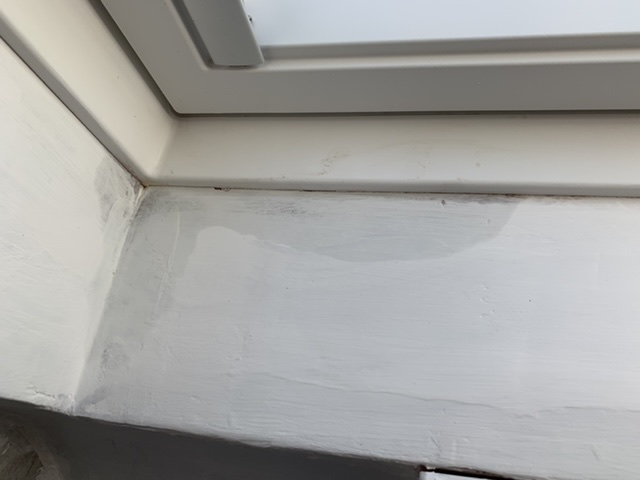

Today I noticed what appears to be a leak in the bottom left of my velux window. It appears to be a damp patch, but it’s barely noticeable that it’s damp to the touch. It’s not wet wet or anything. We did have a lot of rain last night, but I have a vague recollection of seeing something smaller months ago and dismissing it as poor / discoloured paint (long story). My point being I’m not 100 % convinced this happened “overnight” during the rain as opposed to being a slow / progressive issue.

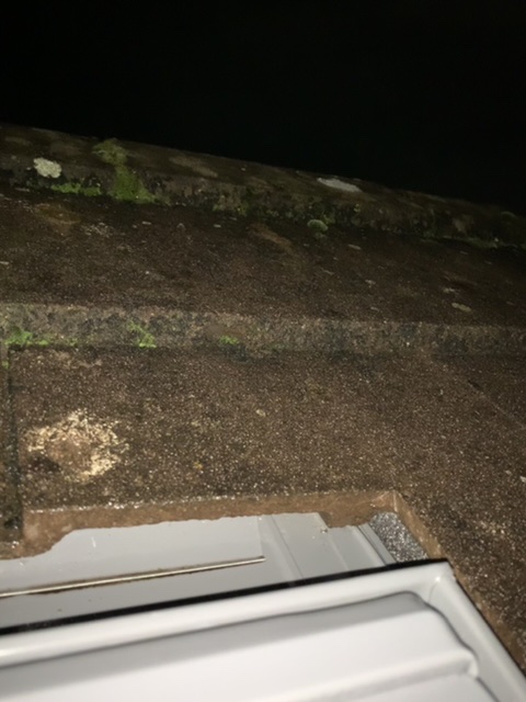

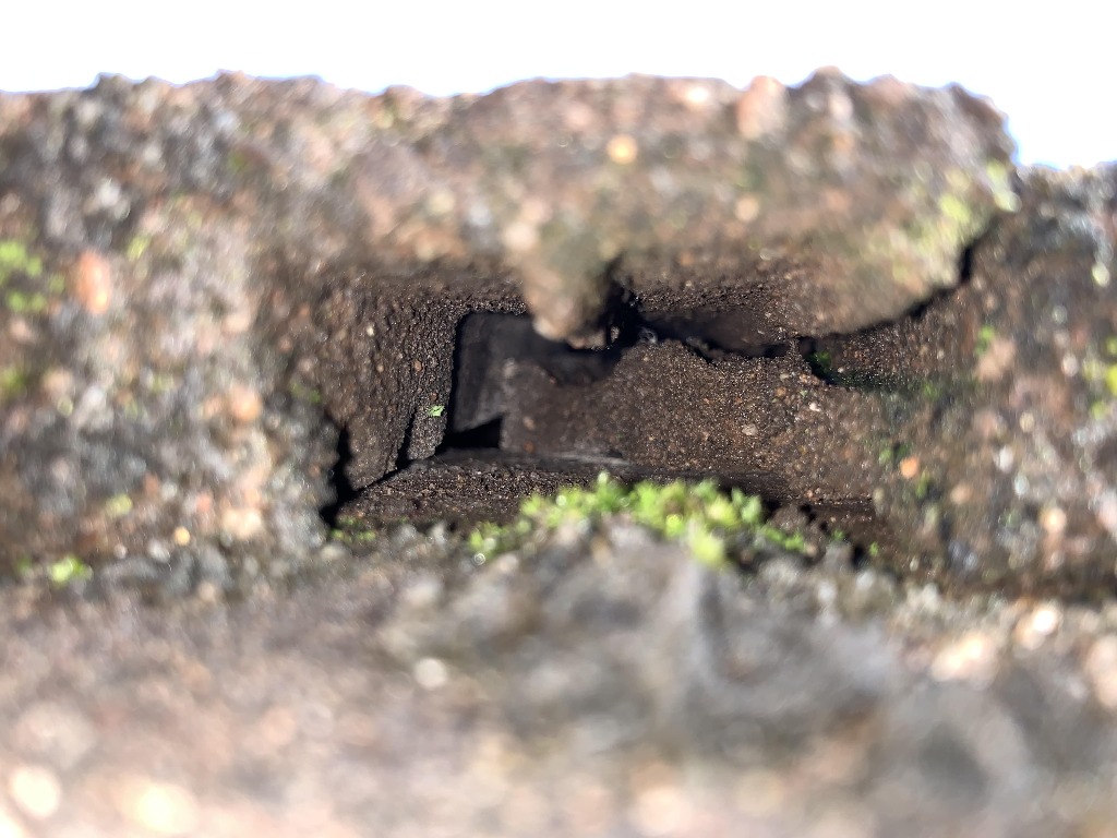

Except there is one potential problem tile. When looking out the window and up the roof, it is 2 up from the velux (ie one overlapping the tiles that would have had to be removed during installation). It’s on the same side as the damp patch. These are the concrete overlapping tiles that overlap adjacent tiles with a top and bottom “lip” overlap and their side edges - as well as overlapping each tile above and below. I hope that’s clear as I don’t know the proper terms, sorry.
The only problem I can see is that the end 1-2 inches of the under “lip” (where adjacent tiles overlap) is missing from one of the tiles. I mean that the top part of the tile on the left is perfectly fine and aligned, but where the tile on the right would have the lip part that goes under the left tile is missing a short segment at the bottom.
As far as I can see the missing part is not long enough to mean that there is any missing “lip” far enough up to the tile so that the missing segment goes far enough up to reach the overlapping tile above it. And even in the rain I can see a clear dry few mm around the edge of the missing segment - so it seems there’s no way for water to ingress and it’s an unimportant chip. Could have been there 30 years for all I know (and I can’t see how the installers would have caused it just from sliding a tile in/out below it). So I’m inclined to think this is coincidence rather than water getting in and tracking all the way down to the window - but I mention it just in case it’s not a red herring. A pic is attached but sorry it’s not good as I only found this forum now it’s dark. I can take one tomorrow in the light if that helps.

Anyway - after all that background (sorry but I thought it all might help) - my question is, does the patch in the attached picture seem plausible to be a condensation issue that could be managed with a dehumidifier - or is this obviously a proper leak?

The missing tile segment
The damp patch
The damp patch

stoneyboy wrote:Hi py9mrg
If you get a lot of condensation on the inside of the glass this could run down the window an onto this corner. It is more likely to be defective workmanship to the flashing and underfelt on the bottom corner of the velux frame.
Probably worth removing a few of the lower tiles to see if a waterproof join has been made.

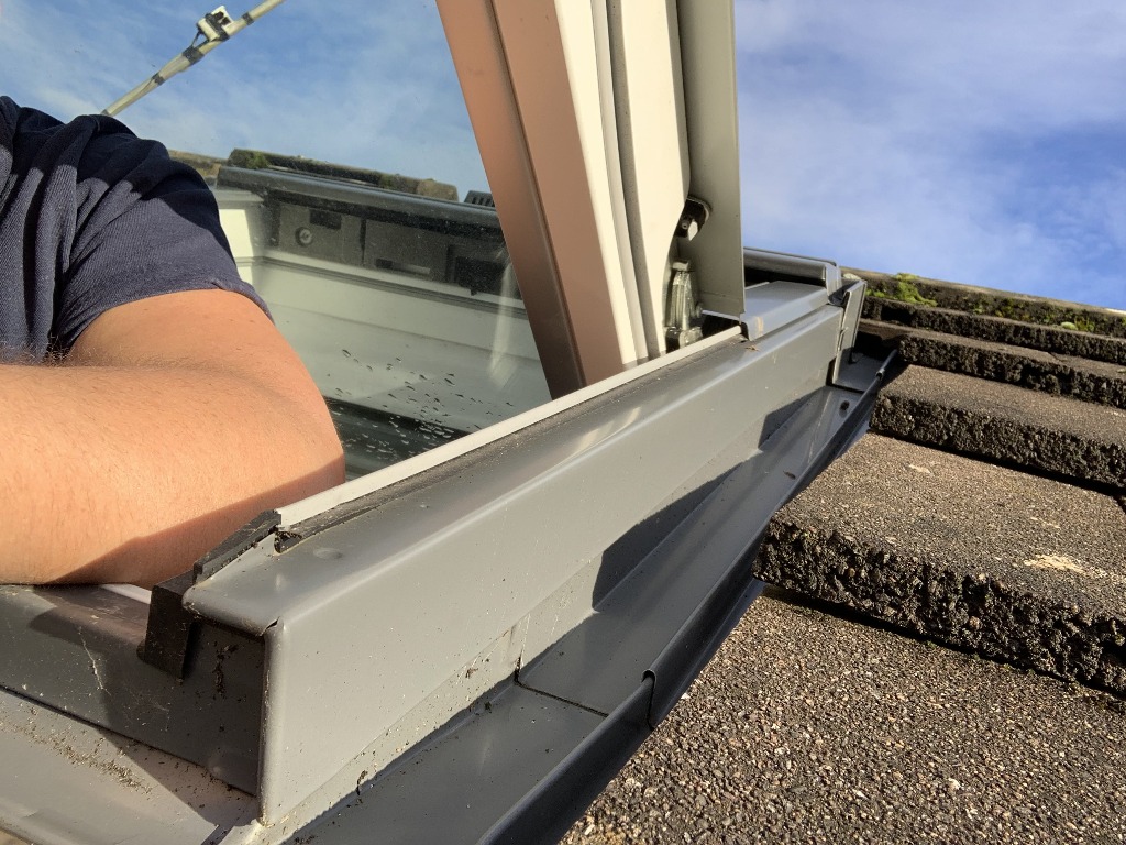

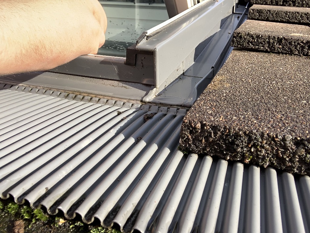

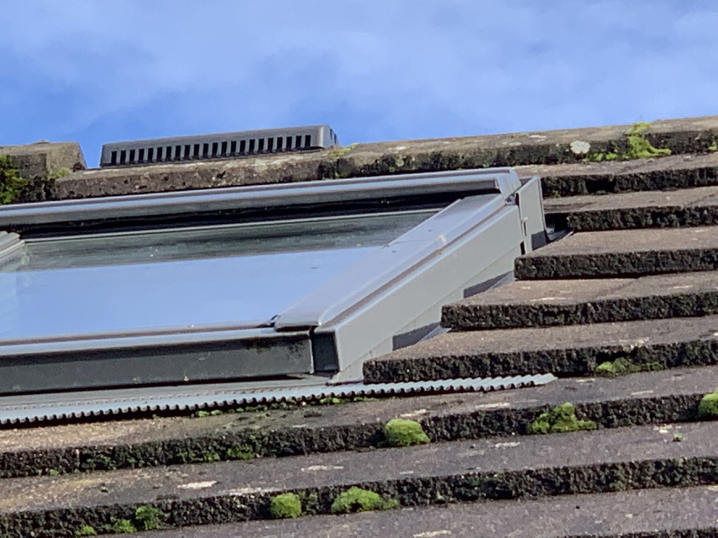

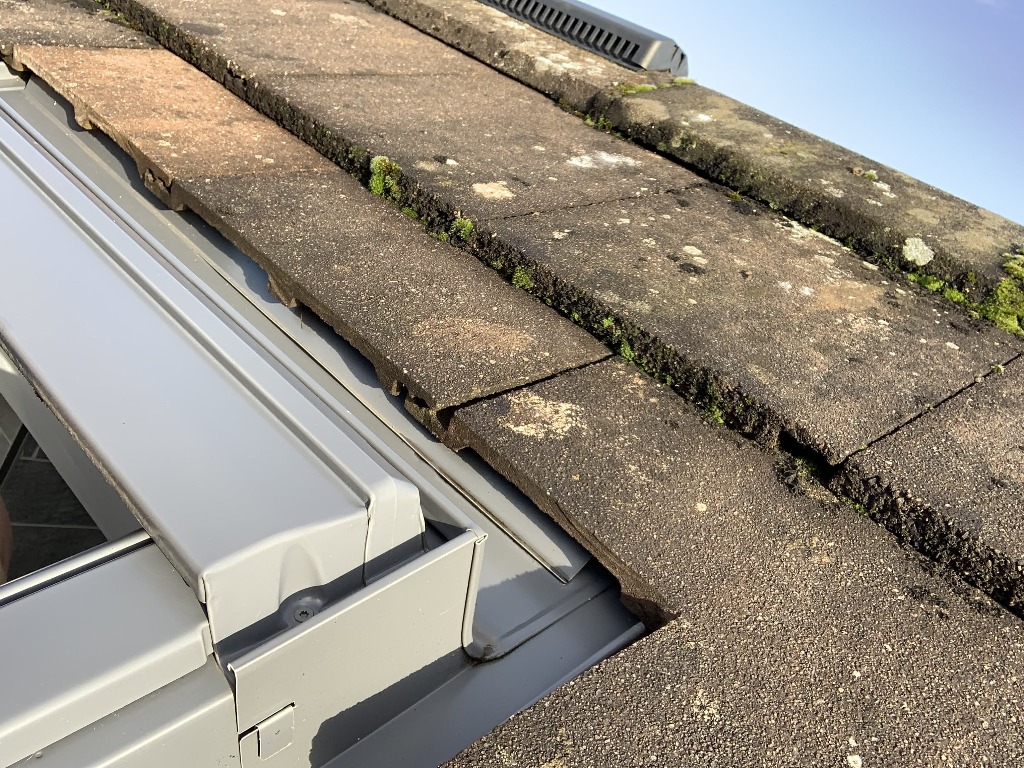

Hello again,
I haven’t been brave enough to remove any tiles but took some pictures of the relevant side, top and bottom corners of the window (you can see the location of the tile with the missing channel, and up inside too). Don’t know if there’s anything obvious you could see from these?

by stoneyboy » Fri Jan 01, 2021 10:52 pm
Hi py9mrg
The installation looks fine and no obvious defects.
The issue may be with the underslaters felt around the opening made when the windows were installed. The only way to check this is to remove tiles around the window and the flashings. Once you get to this stage if a BDX/BFX kit is not fitted it’s probably worth fitting one. Look for the one with the drain channel which fits at the top of the window.
