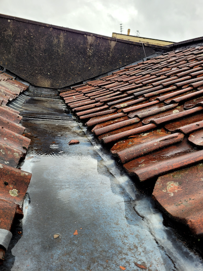

I have a very old roof where rainwater runs down two tiled flanks which (almost) meet in a central flat valley (gulley?). See the attached image (which is slightly rotated!).
There's a leak which is only evident during heavy rain. Water is pooling on the flat valley just above the leak. It is supposed to flow to a gutter at the other end of the house, and it does to a large extent - just not when the rain is particularly heavy.
The obvious repair is to replace the valley entirely, but someone suggested a cheaper option of fitting a new slightly inclined valley just above the original. It would probably only need to cover about half the length - the rest of the valley )not in pic) is draining OK.
Does anyone have any experience or advice about that?

If the roof is that old, change the whole valley. If you do half a job it often costs more in the long run
