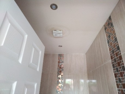

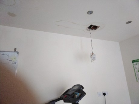

Thanks for the reply. I've attached a couple of photos. It's rained so you can see the pooling. I'm not sure how much is normal - the patio had dried from the rain when this photo was taken. I think your right about the leak detection - a lot to pay to be told the roof needs replacing! Inside, we took the vent cover off so the water would come straight out, as advised with a previous bathroom leak. The area around the vent feels spongy to walk on, and it does push the water out faster when you walk on it - the insulation is acting as a large sponge. It starts dripping a few hours after the rain starts, and continues for days after it stops. Thanks for your advice. Andrea

I am not sure about the need for vents through the flat roof, these vents appear to be the main source of the water ingress. Clearly whatever flashing has been fitted around the vents they is "not fit for the purpose". If you have windows in the extension it would probably be best to remove the vents and make good the holes. This would involve interlayering patches within the existing roof layers. As a short-term repair you could try applying beads of silicone mastic along all joins you can get to around the vents.

One other thing you may have to address is whether the decking (the top boards of the flat roof structure) have degraded due to the water ingress, especially as you think the area around the vents feel spongy.
Moisture resistant boards should have been used and these would not become spongy.
