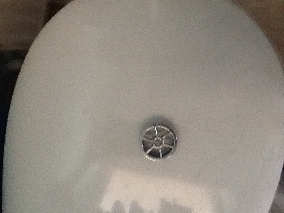

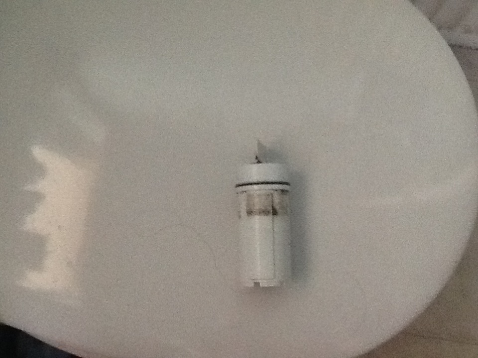

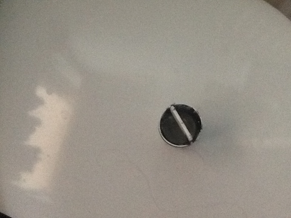

bNot much to photograph but I'll show what I can
As you'll know by now I'm no plumber don't know the names of the parts that come easily off the waste water areas.
Thank you for your help (let's have a look)
Redpanda
Posts: 7
Joined: Fri May 20, 2016 6:52 pm
Re: Leaking Pipe Work of Mira zest Shower Help Needed
by Redpanda » Sun May 22, 2016 1:24 pm
Waste plug hole ??
Waste plug hole ??
Waste pipe from shower

those parts don't make a seal, is there a panel you can remove to look under the shower at the waste pipe
