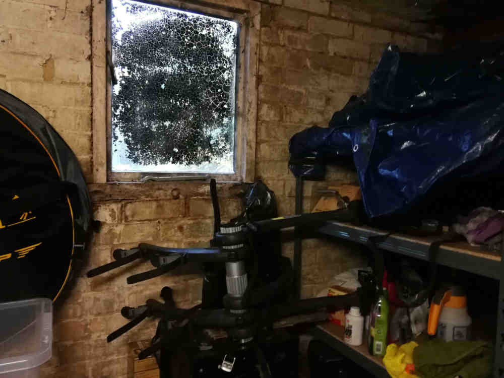

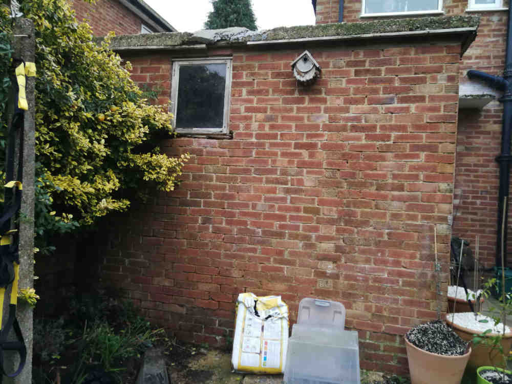

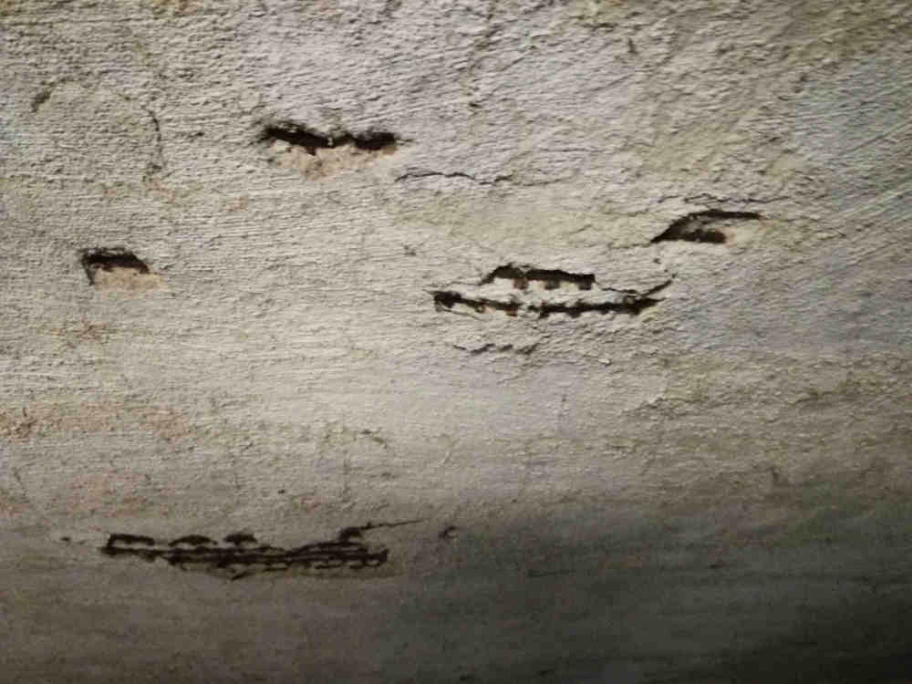

This is a 4M long by 2M wide building, single brick outer. DPM in the floor is OK I think, you can see some blue sky through the brickwork so it needs repointing. A window frame has rotted so the whole thing needs replacing. The roof is reinforced concrete and has become damaged to the extent that rain directly comes through in some areas. You can see that the steal struts have become exposed inside the concrete and are rusty. I do not think the structural integrity is significantly compromised. The damp has also made the internal ceiling plaster wet and this has come away in some areas.

Chip away the old 1950s plaster using a hammer and chisel, leaving the internal harder concrete and metal exposed! Paint this internal surface with some kind of damp proof membrane primer and then replaster the ceiling.

External
External
Ceiling
Ceiling
Internal
Internal
