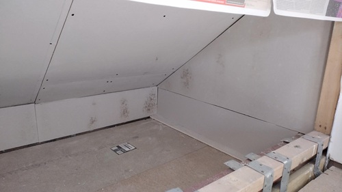

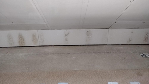

I'm converting my loft in a 1900's solid brick terrace house. Within the Eaves areas I have applied PIR board & insulated plasterboard to the inside of the roof area. However on the exposed internal & external walls within in the Eaves area I tried fixing plasterboard with dot & dab adhesive. However mould appeared on the plasterboard last winter which I believe was due to a cold bridge from the external walls through the dot and dab.

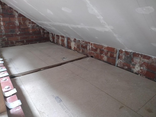

For cosmetic reasons I would like to be able to finish the brickwork within the Eaves with either a plaster or plasterboard finish. But if it's less risk not to do this then I am content to leave the existing brickwork.

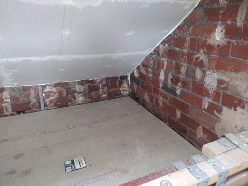

Traditionally my house was designed to have had an open moisture system where water passes both internally/externally between the solid brickwork. I think rigid internal insulation solution might potentially cause me problems with condensation. I also have ceiling timbers embedded into the brickwork, so keen not to create any moisture problems that could potentially rot them them.
The options I'm thinking of are:
Option 1 – Do nothing. Leave the brickwork exposed and this will be breathable. Uncertain whether mould would form on the brickwork.

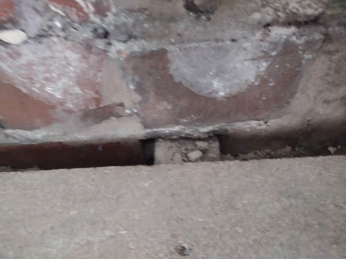

Option 2 – Apply an insulated lime/cork based plaster. Avoid bridging to the ceiling plasterboard so the lime doesn't eat the plasterboard. Leave a 50mm gap at bottom of plaster to allow ceiling timbers to get airflow.

I have found that sticky foam is ideal where you do not want conductive fixing and need to leave a gap behind the plasterboard, just don't compress the foam.
