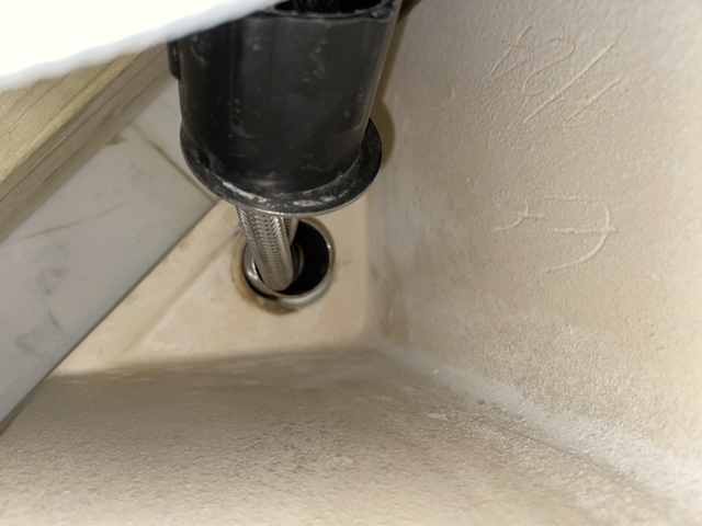

Not come across this system before. No bolt to tighten.
Have tightened the threaded black plastic bit but makes no difference.
Any advice would be much appreciated.
Tom

Hi crowds
Suspect the black piece that is down the flexibles is the clamp mechanism for this tap - try screwing it back up.
