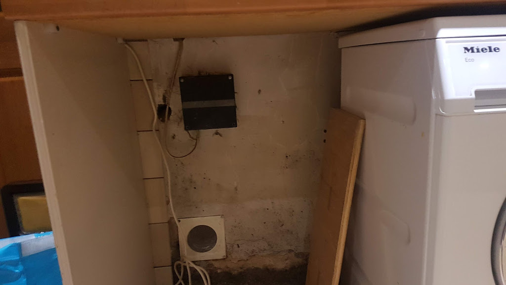

I'll be getting a sparky out to check this but just wondered what this black metal box is on the inside of an external wall. Anyone know?
It has a cable going into the wall. It might be feeding a garden light it it's not really in line with it at all. There is another modern isolation switch on the wall itself.
Its about 6 cm deep and 17 cm square. It looks very old , and the previous house owner also doesn't know.
Mystery box
Mystery box

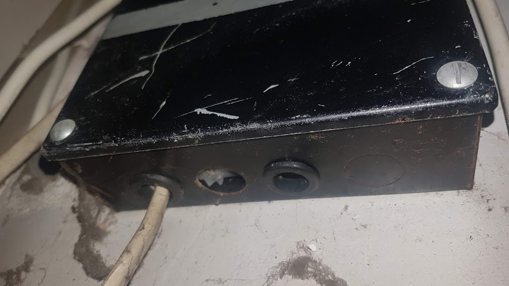

This is underneath - looks like only one cable possibly.
underneath
underneath

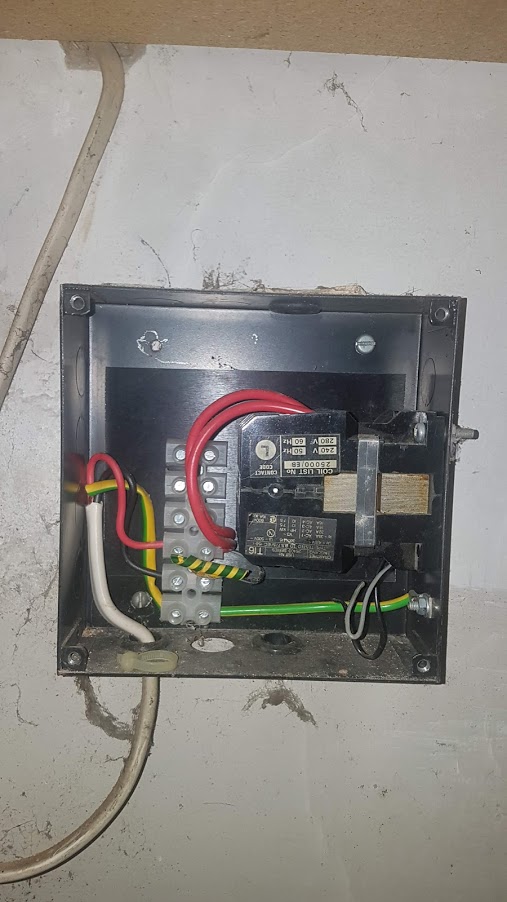

I bought a non-contact test and it turns out the cable is live - and is terminated in a 240v contactor volt coil?

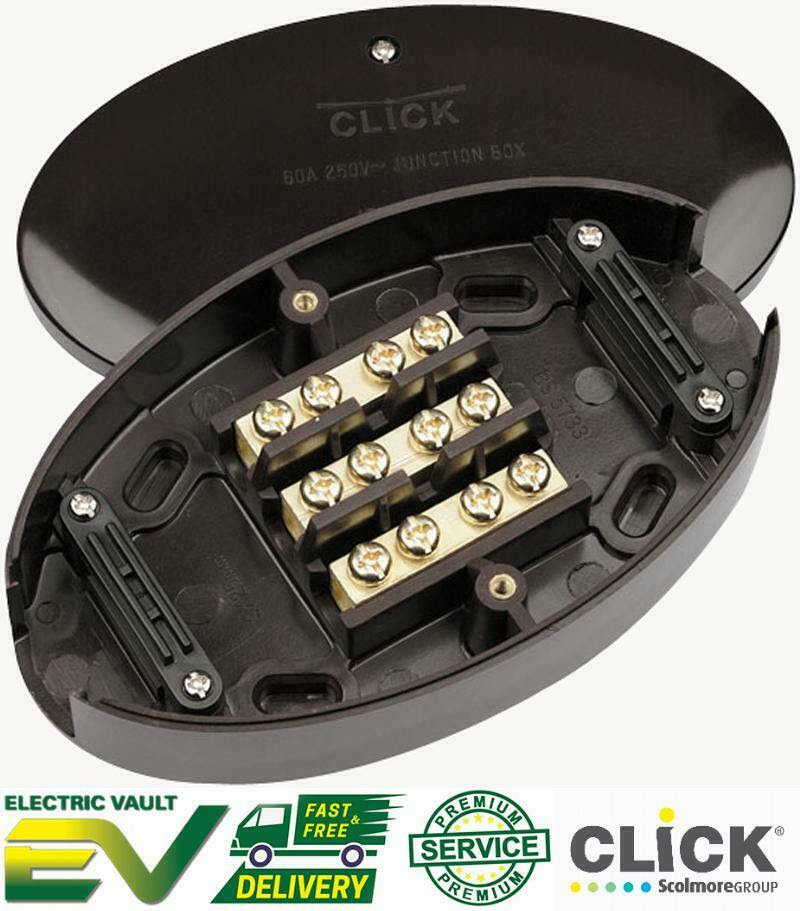

The adapter box is 6cm deep and I'd just like to remove the coil and terminate the cable in a lower profile surface mounter termination? and ensure the other hole is blocked. (eg see image)
Would that be OK?

To do as you suggest you would have to isolate the supply and make it safe ("dead") since you are doing that, follow the cable back to its source and disconnect it from there permanently.
I did not suggest it earlier as I had no idea what it was connected to.
