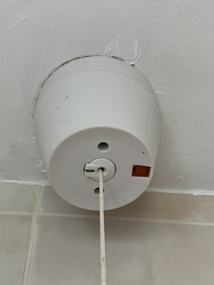

I attached pictures with the Consumer Unit and the Electric Shower.

Sometimes people will install a larger rated shower than the cable is suitable for because they know no better. The determining factor is what is the cable size?
The cable size is 6mm.

I would suggest no more than a 9.5 kw shower. So your suggestion of 9kw is fine.
