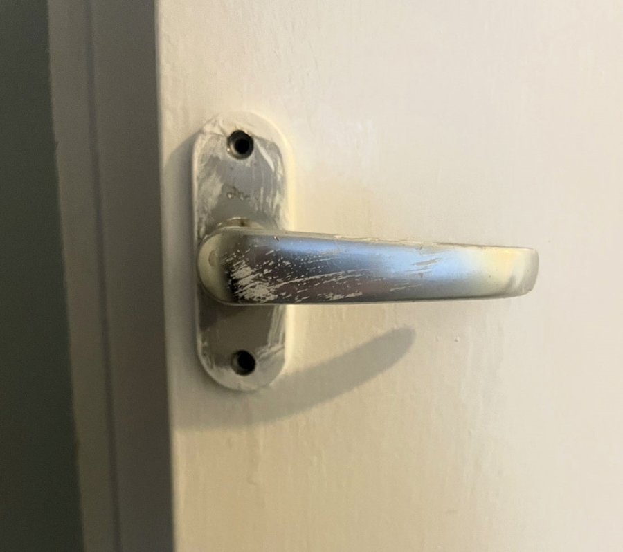

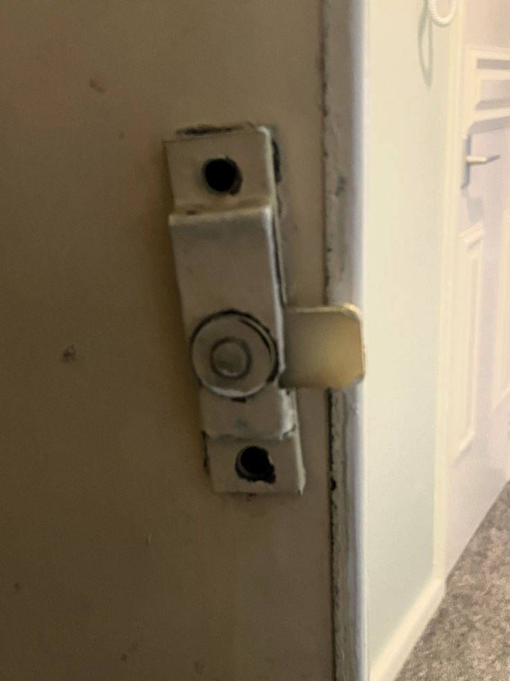

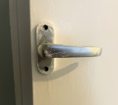

Hi, does anyone know what type of handle and lock this is in the attached images?
I think it's from an old heating/boiler unit cupboard in a high-rise flat and the door and thin metal.
I have removed the screws but there does not appear to be a way to remove it.
I want to remove and clean them up a bit.

The latch is just a force fit so use a punch to knock the handle shaft out of the latch.
