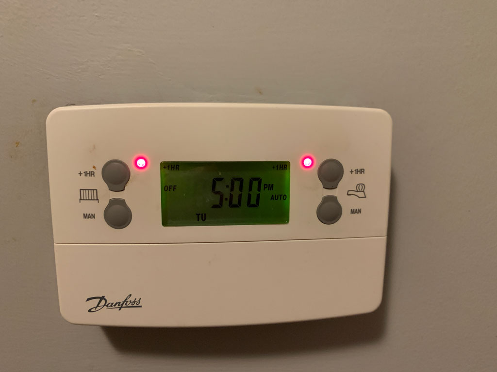

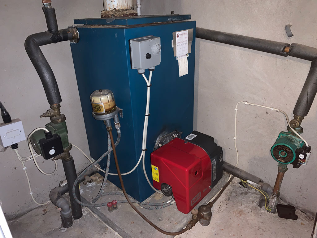

Hi, when I purchased my home 20 years ago from new I asked for a four pipe system to fitted. I have an oil fired warmflow boiler with a Danfoss control unit. I can have separate hot water, by pressing the hot water on the control unit and to get heating I press both the hot water and heating buttons together and get both the hot water and heating working together. It is only now after being advised my Control until should be able to have have heating only. When I press heating only on the unit, the Led lights up but the boiler doesn't fire-up. Can anyone advise what the problem may be.

Thanks for a very comprehensive reply. From my limited knowledge I must have at least one motorised valve. Using my logic, when I press the hot water button on my control unit, only the hot water boiler heats. When I press the Central heating boiler, the heat comes on. How does the central heating pump get the power to switch on, because if I press this button only, it doesn't power up, only when I press the two together.
I have a hot water tank thermostat which is set at 75, I read it should be set at 60. If the hot water in the tank reaches say 75, does this signal to the control unit to switch off. If this is the case my heating would switch off, which I don't want to especially in the winter.

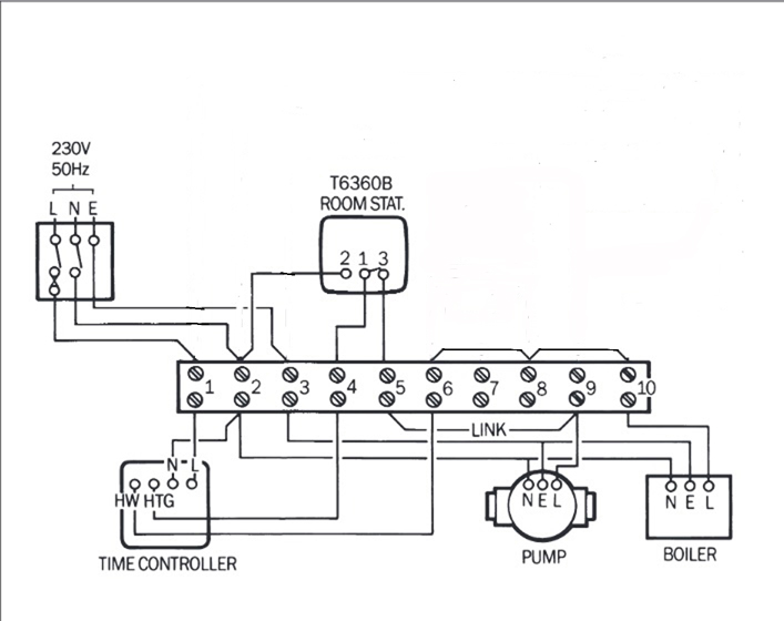

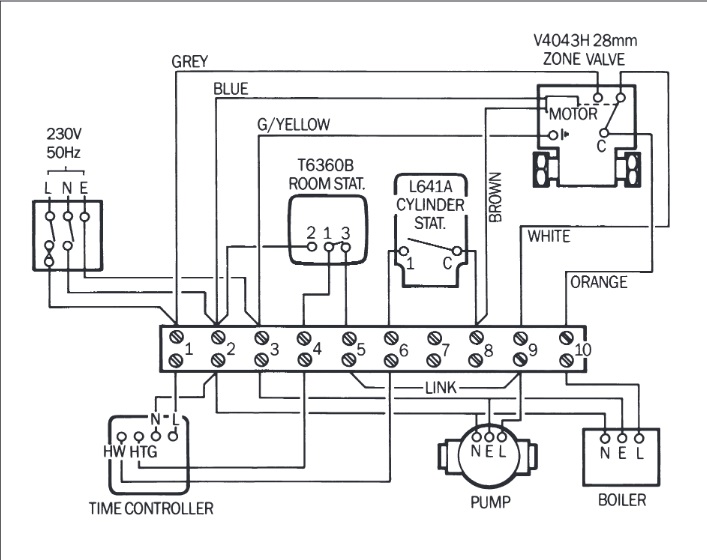

Valves if fitted normally either at boiler or at the cistern. [attachment=1]C-Plan.jpg[/attachment]
Above is the full C Plan, and below is very basic C Plan.[attachment=0]C-Plan_old2.jpg[/attachment]
There is also one half way between the two, it was the most common method, and the early version was often used to pre-heat home in morning and evening before the fires were lit, it was never really used as only way to heat house. However with modern programmers the old system can be made to work quite well, I have a Nest wall thermostat and 9 electronic TRV valves and it does a reasonable job. But in summer there is a problem, how long to run the boiler to get the water warm enough? The idea is water should be over 55°C to stop legionnaires at least once a week, but I have no thermostat, and the boiler starts to cycle after 20 minutes, the cylinder just can't absorb the heat quick enough, what I want to do is add a timer for the immersion heater which is thermostatic controlled so after boiler has run, the immersion heater can run and ensure at least once a week the water is hot enough.

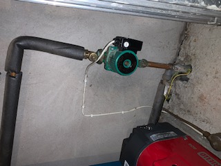

Hi, Eric, once again thanks for your help and the drawings. I don't think mine is wired / plumbed like that. I'll try and explain the way I think it is has been installed. At my boiler I have two pumps, the black one feeds the central heating the green one the domestic hot water ( see attached photos). I have checked the electrical wiring at the boiler. When I press the DHW, the boiler fires and the green pumps starts and heats the hot water, with 2 pipes one going in to the pump from the house, going in to the top of the boiler and coming out of the boiler and going back in to the house. When I press the Heating only, a signal is sent from the control / programmer unit and the pump runs ( black pump in picture), only the boiler doesn't fire. Once again there is a pipe from the house going in to the top of the tank via the pump and coming out the bottom and going back in the house. With my limited knowledge of plumbing, could it be as simple as a strap missing( white electric switch) where the electrical feed comes from the Programmer that when the pump gets a signal to switch on and run, this strap extends this signal to start the boiler.
Also could you advise what speed you set the pumps at. The Domestic Hot water is set a 2 and the Heating is set at three. I have read somewhere, that if the heating pump is set too high it can cause air in the radiators. I have one radiator which I have to bleed continually and it has been like this for nearly 20 years.

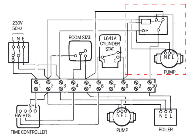

[attachment=0]C-Plan_twin_pump.jpg[/attachment]I have thought about twin pumps, and this would work, however if you look the pump and relay in the red dotted lines is doing the same job as a motorised valve, so really don't see why it would be done?

But in your case to try and work out what you have is not easy, I see some steel wired armoured cable (SWA) going into a box at the side of the boiler, and that box could have a relay inside, and in real terms it could be hidden anywhere.
