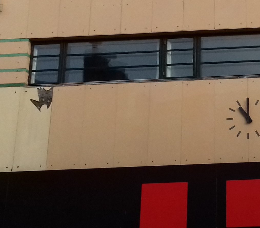

Just joined and saw your post. I don't have an answer, but have a similar problem. We recently moved into a residential block which has an art deco frontage of coloured glass. The material is vitrolite, which is a coloured glass. It is no longer made. 4 of the panels are plain glass that have been painted. I suspect that during the build some of the panels were damaged and were replaced with plain glass. Apparantly according to residents the paint keeps peeling off, as it is at the moment. I have the same question that you posed - how do you paint glass so that it does not peel off? Is there a paint that adheres to glass?

Found something called Polyvine acrylic enamel paint specially formulated for painting glass. It seems to be an artsy crafty sort of paint and is sold in small 50 ml pots so probably not suitable for my needs for covering 3 or 4 sqaure metres. But is acrylic likely to be better than enamel? The damaged panel can be seen on the left. There is a similar panel on the right.
